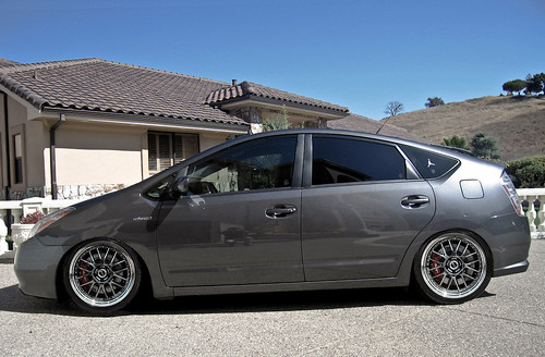

  19. macmaster05
    macmaster05 Senor Member
    Sep 27, 2009
    4,050
    730
    Jialideel, DUMP IT, like this!
    Dang you is fast. I wanted those Volk rims when he was done too.
