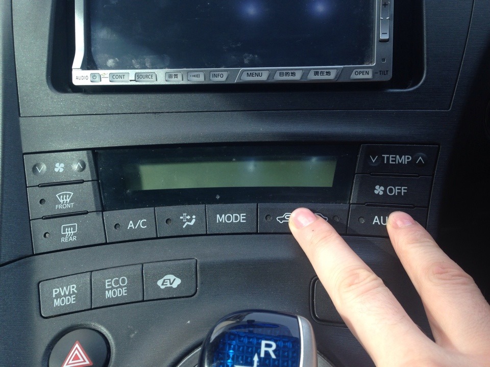

    With the car turned off, press and hold two buttons on the climate control - air from the cabin (or from the street) + the AUTO button and press the start button to turn on the ignition.
    Error numbers are displayed

    By chance, if there's stored code(s), will the code be displayed as number on the HUD?

  11. ChapmanF
    28,701
    19,003
    Also, in a gen 3, you can use any suitable OBD scan tool (suitable meaning one that can talk to all ECUs in the car). It will show B14xy codes that generally correspond to the same xy codes you can see using the display as described above.
