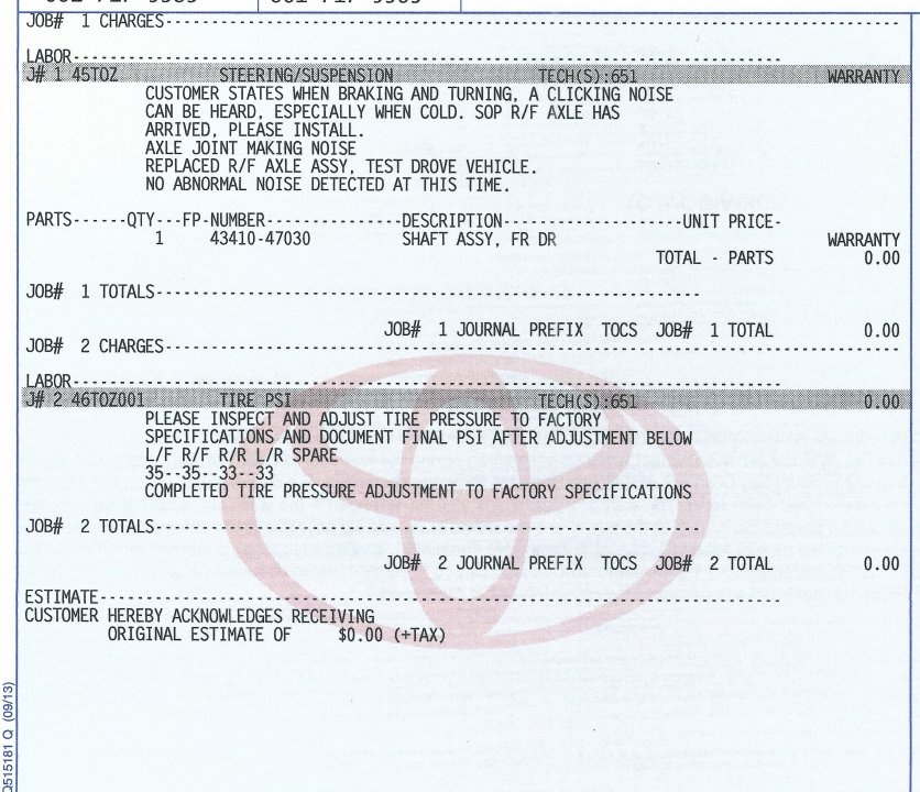

    My Toyota dealership service department has probably serviced 10's of thousands of Toyotas if not 100's. When I brought my cars to them for repairs it seems like they've never heard of the problems I have. I know my Toyota is not unique and there are others have the same problems as mine. I've taken technicians on road tests numerous times. It seems like they're trained to not hear noises. I've taken my Prius in at least 3 times for the same noise last year. On the last they finally isolated the problem and repaired it. Well, this year the noise came back. This time they knew what the problem was. They told me it's shaft assy, FR DR
    DRIVE AXLES for 2012 Toyota Prius
    I think this ebay is only a part of it.
    Preeeus, steveinsaugus and telmo744 like this.
