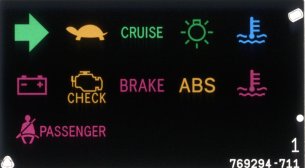

    WAS THIS IT?

    That is weird, considering from your description of where it's located, it would have to be one of the actual pre-cut indicator symbols with a lamp behind it, and not something painted by software on a bitmapped screen.
    Your car has the funny instrument cluster design where the part you 'see' is just a smoked screen, and the instruments are down below it in the dash projecting up onto it. Maybe if you stuck your phone in there at a good angle and took a flash photo aiming down, you could show us the (mirror image of the) symbol card and point out the one that you're asking about. It would look sort of like this (except this is a Gen 1 version):

    I don't have a turtle ..

    And you are lucky to not have one. It is not good when that light appears on the Classic dashboard.
