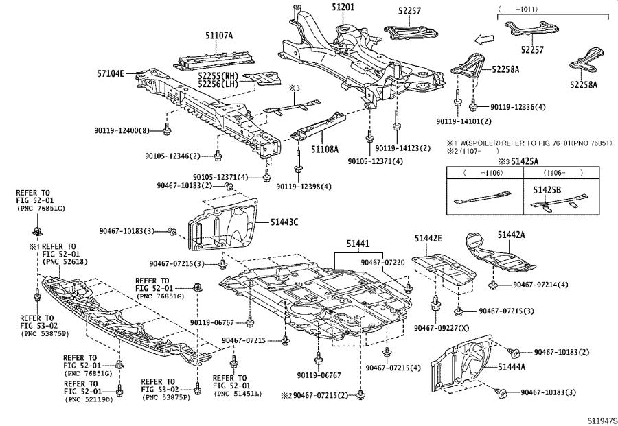

    What do you call those little plastic things that you use to hold the cover that covers the underside of the engine and transmission area and where do you get them? Thanks

    You call them vulgar names like 90467-07215 or 90467-07220, etc., depending on which ones you're looking for.
    Things with a 90467- prefix will often have a description like "CLIP". Short, to the point, and because there's just one word and no commas, no problems with people saying it backwards. :)
    But of course you need the full part number to specify which kind of clip.

    Part nos are conveniently summarized in the attached TSB; you can obtain through dealership parts department, or online through sites like Parts.Toyota or Amayama.
    The aforementioned sites have the diagrams like the example @ChapmanF posted. Finding them requires inputting your car info, then drilling down through the categories. Parts.Toyota in particular is invaluable in the States: it’ll locate parts, show suggested retail price, and provide links to dealerships local-to-you that have the parts, and their “street” prices (usually lower).

    That diagram is very useful Thanks I looks like the shroud uses different kinds of clips Can I just get a variety pack that has some of each clip?

    The main clips you need (from prev attachment) are 2 of the #5, and 10~12 of the #3 (verify qty in attachment) #4 are plastic/plastic, a pair, you may or may not be missing.
    I’d stick to Toyota, see what a dealership near you is asking (via parts.Toyota site).
