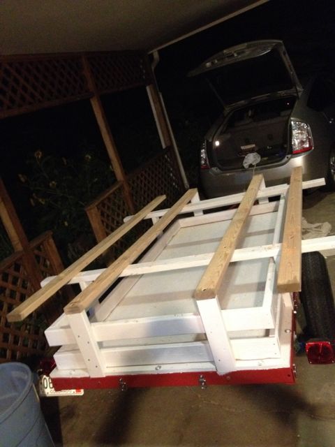

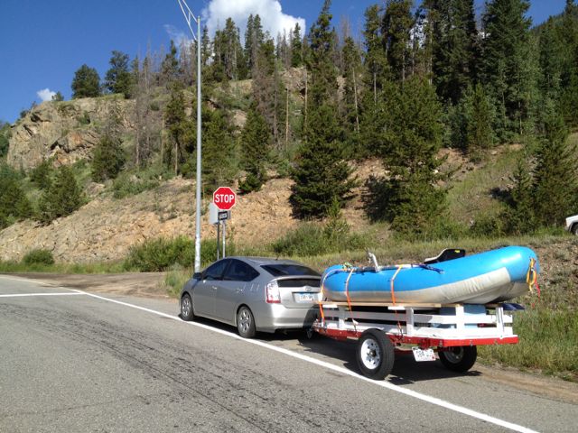

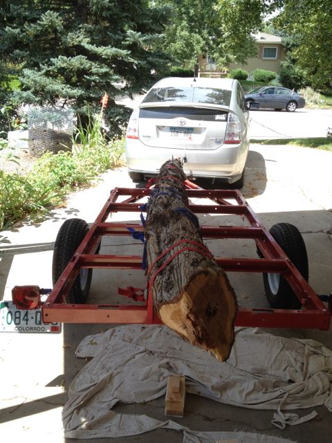

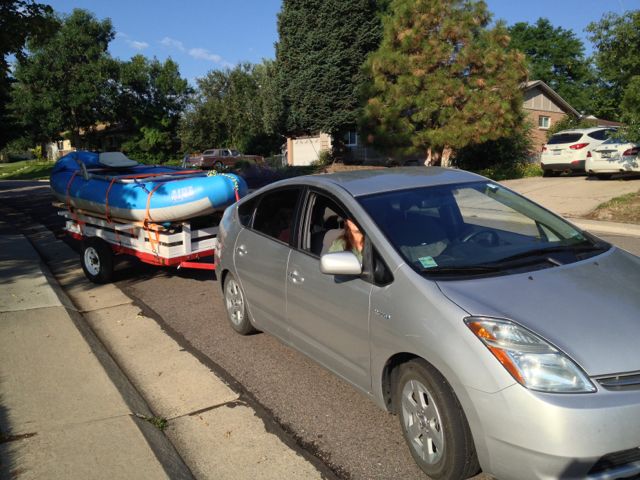

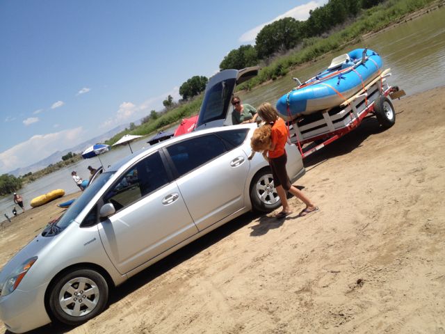

    We've had a Curt hitch for years for a Saris bicycle rack. I just bought a Harbor Freight utility trailer. It was $370 on sale but I used a 20% off coupon and got it for less than $300 before tax. I spent another $244 for some larger wheels from Amazon (this included a spare). The wheels that came with it say "Max speed 55mph" and the manual says not to go faster than 45mph. I suspect I would have been fine with the wheels the trailer came with but I didn't want to chance it. The trailer is rated for 1,720 lb. The trailer itself weighs 260 lbs but probably closer to 300 lb with the new wheels and the spare. I never intend to get close to 1,000 lbs total. I live in the Denver area and had an approximate 300 lb log to haul to a friend's house to cut up. I took the Prius with my wife and me in the car over Berthoud Pass (11,307 ft) and the trailer and Prius did fine. I was passing people on the way up but very cautious on the way down. I managed 36.7 mpg for this. I would say that is pretty awesome. That was the test.

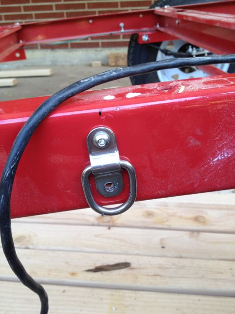

    Next, I built up the trailer for hauling our small Aire Puma raft and gear for a multi day raft trip. We took I-70 from Denver to the Utah border and managed 29mpg with 4 passengers in the car (and 1 dog). I stopped multiple times along the way to check the raft pressure and the trailer bearings temperature. No problems with the bearings, the trailer, or the Prius. The slowest we went was 52mph on some of the steeper hills. We spent much of the time going 75 mph with no issues. On the way home, we blew the raft and rolled it up for less drag. The roads are steeper on the way back and our slowest speed was 45mph (going up Vail Pass and approaching Eisenhower Tunnel). On the way home, we managed 35 mpg. I'm super happy with the trailer and the car. I used Timken grease from Amazon for the bearings. I also attached some tie downs on the sides of the trailers for straps.
    PriusTrailer1.jpg PriusTrailer3.jpg PriusTrailer4.jpg PriusTrailer5.jpg PriusTrailer31.jpg

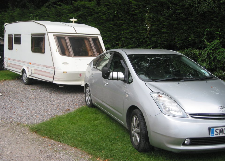

    Just finished a 450 mile tour with my caravan taking in the UK counties of Somerset, Devon, and Cornwall. My last stop being at Cheddar Where the "real" Cheddar cheese comes from.
    The Prius returned a very healthy 49.8 mpg with a mixture of motorway and rural roads.
    John (Britprius)

    Perhaps I should have made it clear these are UK gallons "larger than US gallons", and I never exceeded more than 55 mph on motorways, and 50 mph on other roads. I was however surprised at only loosing around 15 mpg against my normal figures. The HV battery state of charge did drop more quickly on hills than it normally does, but never went below 3 blue bars. I also gained more regen when slowing down often filling the battery completely with 7 green bars.
