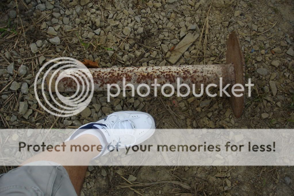

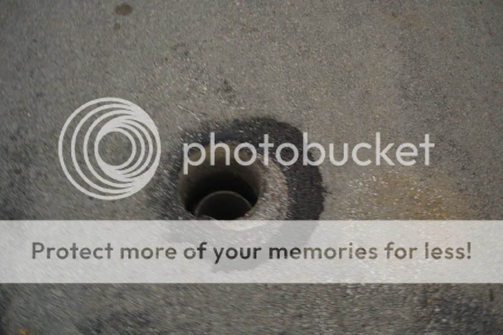

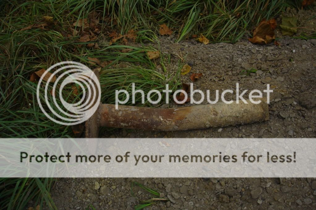

    No secret - this...
    was sticking up out of this (see above where the pipe is bent? That's how high it was sticking up.)...
    That piece doesn't look big, but here is one next to my foot to give perspective...
    There are dozens of these holes in an area about 30-40 square yards. They are drilling and pumping in concrete to shore up an old mining cavity to support the roadbed.
