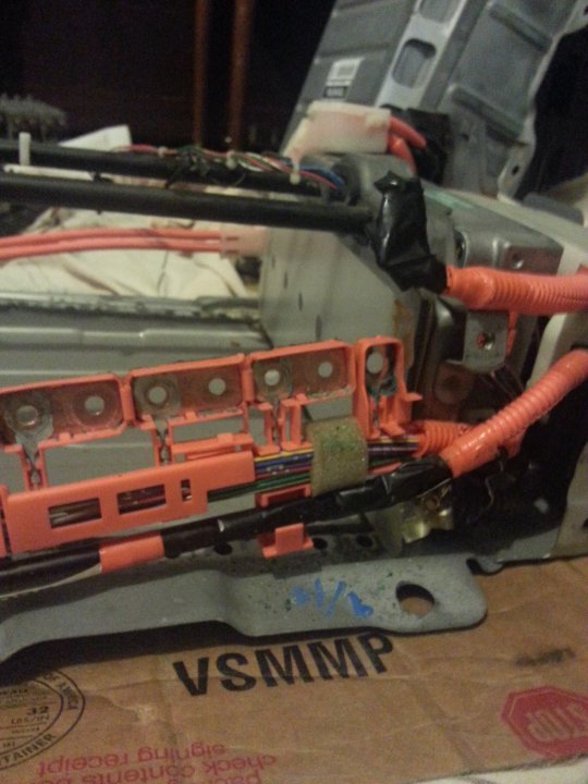

    I didn't mark the orientation of the positive and negative ends of the first module when I removed them to charge them.
    If it's not the same for all gen 1's how do I find out :( 20141128_075417.jpg

    It's on page HV-9 of the service manual. The module pairs are numbered starting at the ECU end, and the output cable attached to pair 1 is positive.

    Yes first one should be positive attached to the fat orange cable, at far right side.
