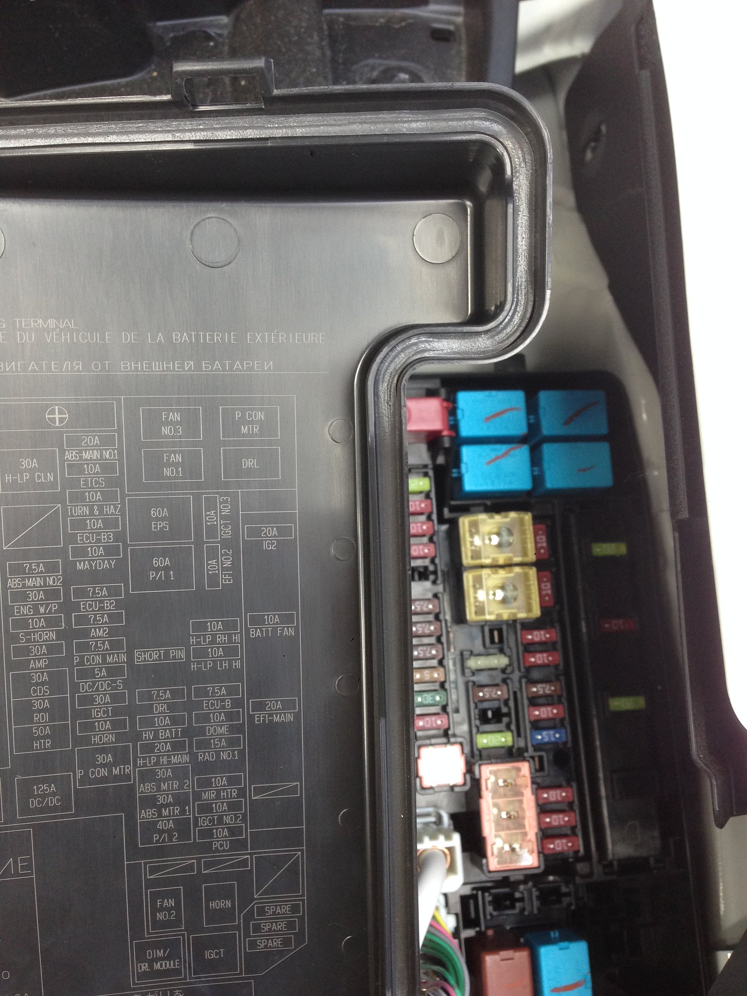

    Ok, you want some oddity - here is a picture of the fuse box/relay panel in the engine bay. Note the DRL relay and 7.5A fuse.
    In the interest of science, I pulled them both (and one at a time) and... nothing happened. The DRL's still function normally, no error lights, no codes, full functionality of headlights/high beams. How can that be?
    So I'm no further ahead re: the idea of swapping the DRL high beams for alternate beams.
    And on that note, I've pulled back the fender/air skirt panel to see that the lights in question are in fact just reflectors, not wired up and don't even have a hole to run wires. Any changes to them would require drilling and mounting what I assume would be a whole LED module.
    Based on offline's comments, I've found the answer I was looking for - thanks!
    And Rico - thanks for the pic, they seem to be additional DRL's for Canadian cars with the LED lights.
