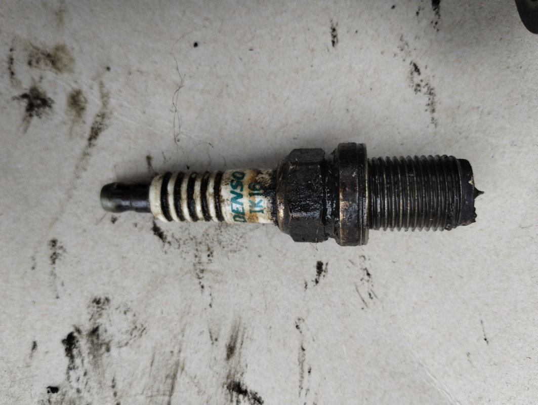

    I am hoping that the destroyed plug was the reason for the leak and not the valve cover. my hypothesis is this
    A. Drove 50mph hit pothole got a flat....it was very violent and I thought my axle broke
    B. After replacing tire with spare and very poor acceleration (NO POWER) on highway which I attributed to the wheel issues however it might be that is when spark plug jarred and broke off at the tip
    C. Prius then drove OK for 2 months until very recently when maybe the oil really started to get to be too much in the cylinder. Then got the P0303 (3rd cylinder code misfire)
    D. Changed plug & coil; hopefully new plug will seal any oil incoming
    cliffs: so it might not be fake DENSOs or anything like that...maybe just plug tip got hit in accident and came off allowing oil to go into the cylinder....we shall see.
    THANK YOU FOR ANSWERING THESE QUESTIONS IF POSSIBLE!!!!!
    1. Is this from the jarring experience of hitting a pothole?
    2. Should I expect any other issues or even this spark plug becoming nonfunctional again?
    3. Is the lack of a spark plug tip the reason for the oil in the cylinder or did oil get in there first (via valve leak or other) and cause the spark plug tip to break?

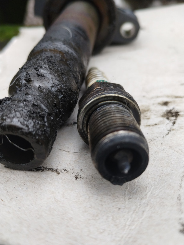

    Gawd danged need to do something about that coil too clean it with some electrical contact cleaners and berryman spray something I would replace that nasty thing probably.

    Do you know if that plug was original, or, if not original, where it came from?

    Those are the IK16 I've run a few of those and it's easy to get those in fakes too You have to be careful I even still have some of the boxes from those those are they're not the TT's they're the IK's I can't remember what the deal is with the IK designation nipondenso over the years have changed all their prefixes and whatnot.

    I replaced the ignition coil as well.
    there is a good chance that this spark plug was a fake. I'm sure I bought if from the cheapest seller at the time online.

    Might want to look with a borescope at the condition of the cylinder; sometimes the question with those fakes is where did the bits go that fell off?.

    1. You'll need a valve cover gasket kit to fix that leak into the spark plug well.
    2. What happened to the ground electrode for that spark plug? Is it still bouncing around in your cylinder or has it been ejected out?.

    Whatever goes into a cylinder from a spark plug hole is gonna be in there until it happens by sheer luck to bounce out an open valve into the exhaust or intake. The oil pan isn't a place it'll end up, unless it gets pulverized first finely enough to get past the piston rings. (Or, a big enough piece of debris might get there by busting through a piston, but I think that'd have to be bigger than a spark plug electrode.)

    Replacing valve cover gasket is what I'm seeing... You likely have an engine that didn't get an oil change very often. Maybe an engine flush before an oil change would help, as well as changing oil a few time with more engine flush in next 10K miles. I wouldn't be too concerned about the other problems people are talking about unless it still runs rough on a new set of plugs.

    but why would there be oil in only one cylinder IF the valve gasket was bad? I don't mind doing a replacement but gonna wait til its warmer so maybe in a couple of months.

    Whenever I've pulled a plug from a failed valve cover gasket there's fresh oil on the inside of the plug as well as on the outside. And I agree that it doesn't make sense that the oil could leak through the threads, but that's what I've seen. I suspect there's a logical explanation for it though.

    One of the o-rings that goes around the spark plug wells is just compromised and it's leaking no big deal it's just a piece of rubber not real special when it gets hard and ate up from thousands and thousands of miles it's tends to shrink and oil will seep in there now you're going to slap a new $9 fell pro gasket down and not going to give a crap about it anymore. Then you could take a magnet on the end of an extension a pickup tool and stick it down the spark plug hole with the spark plug removed and see if you pick up any pieces of metal when you swirl it around in a little bit You could even bring the piston up to the top so if the piece of garbage is way down in the bottom it'll now be closer to you you know the little magnet on the gooseneck is what we want to be using here You rotate the engine around by the crankshaft pulley with a screwdriver stuck in the number whatever hole it is and watch the screwdriver raise up out of the hole to indicate the piston is at top dead center any little pieces of nonsense down in there should now be real close to you stick the gooseneck magnet in the whole and running around carefully pull it out of the hole see what you got do it once or twice if you get nothing no worries.

    That gasket's probably never been replaced so it's long overdue It is not a permanent part keep that in mind
