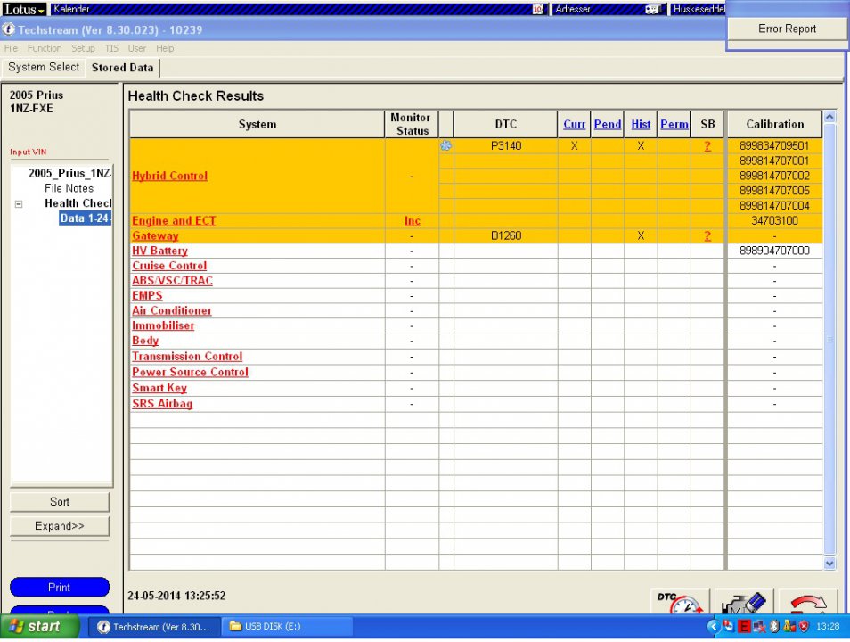

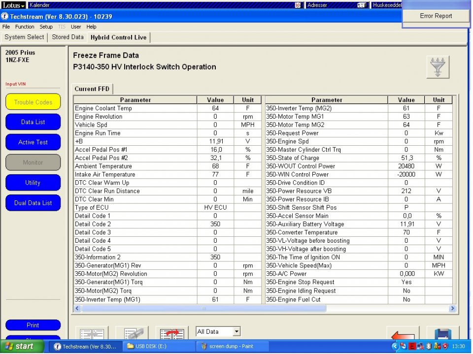

  16. kurt oskar
    kurt oskar New Member
    May 4, 2014
    Jensen got connected with a new mini VCI.:cool:
    I am landed with the "P3140 HV interlock switch operation" and have no idea.
    I have put in a new 12v battery, the old one was not healthy.
    I could see it as an interesting test, to let one of you "mini-VCI-pro"s go teamviewing on my lap in my prius.
    greetings
  17. nh7o

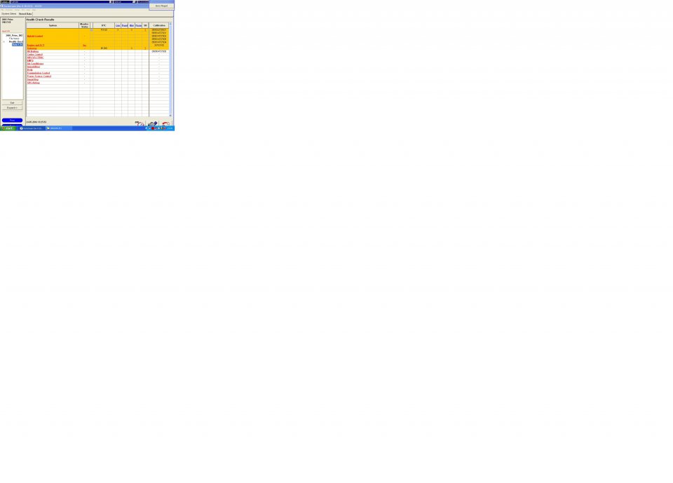

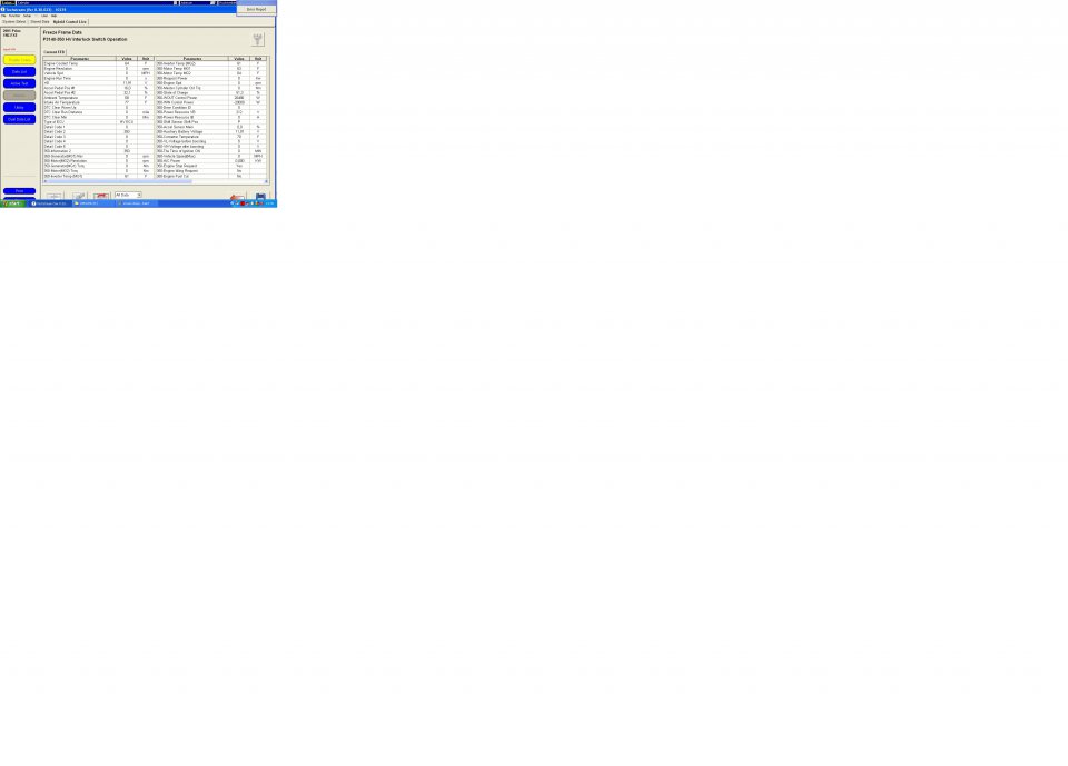

    Please try those screen shots again. The desired portion is small and low resolution, so not readable.
  18. kurt oskar
    May 4, 2014
    now I got the possibillity to upgrade the pic
  19. MTL_hihy
    MTL_hihy Active Member
    Sep 2, 2013
    536
    261
    Maritimes, Canada
    With that code start with this first......cool idea with the Teamviewer option too, might be onto something there (ie remote Hybrid tech support).
    http://ww2.justanswer.com/uploads/snapontech/2011-08-03_151235_toyota.pdf
    #39 MTL_hihy, May 27, 2014
  20. ericbecky
    ericbecky Hybrid Battery Hero
    Mar 12, 2004
    4,451
    3,359
    Madison, Wisconsin
    Look VERY carefully at the service plug.
    Make sure you inserted it correctly AND SLID IT DOWNWARD TO LOCK IT INTO PLACE.
    You're not the first person to forget to do this, and you won't be the last.
