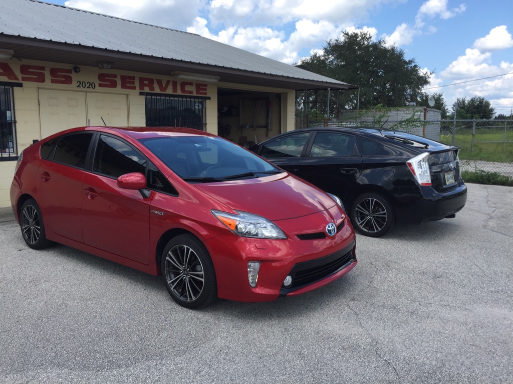

    2015 Scion FRS wheels and tires. I got them for $600. Brand new take offs. We put them on all of our Prius. You either have to use a very thin spacer or grind on the caliper brackets just slightly to get them to clear. Other then that I really like them.
