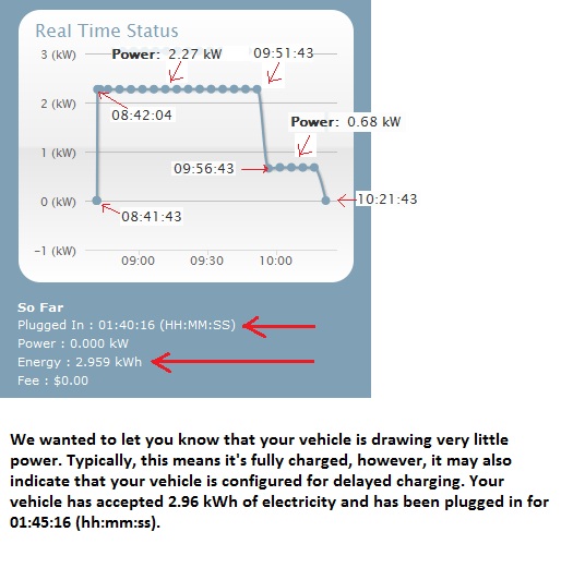

    Here's my ChargePoint 240v charge graph... 1h40min for a full recharge...
    I usually saw about the same 1h30 to 1h40 min charge at home on 240v (241 volts measured under load) too.
