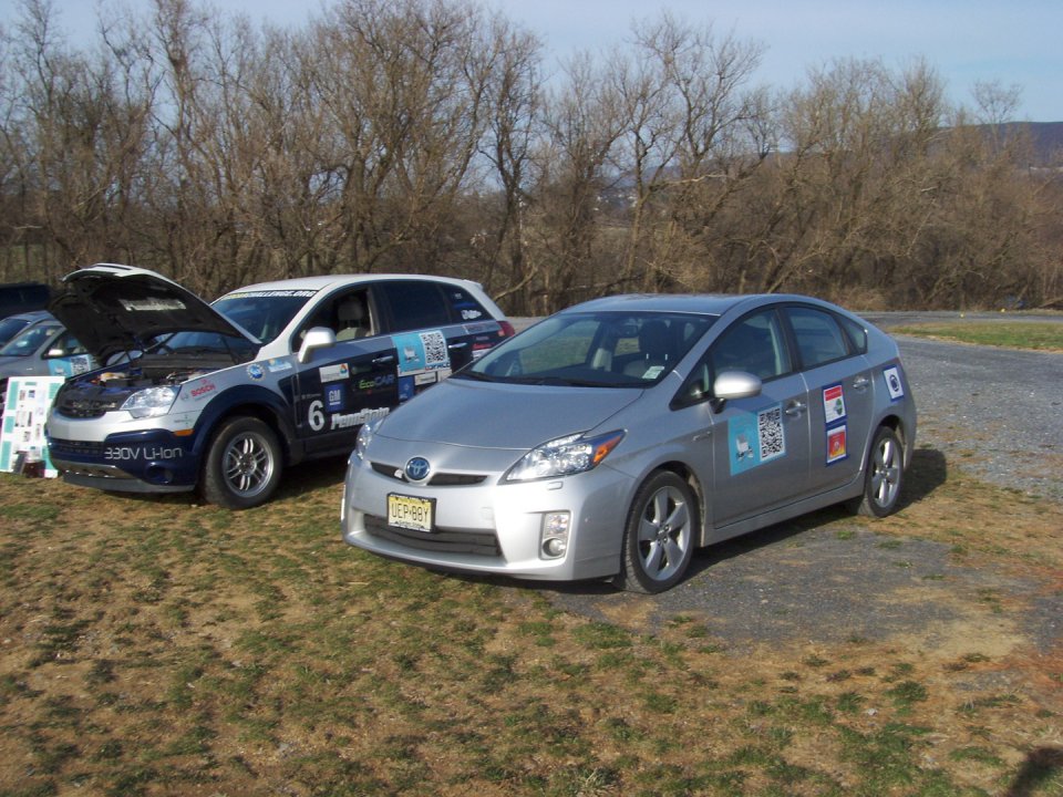

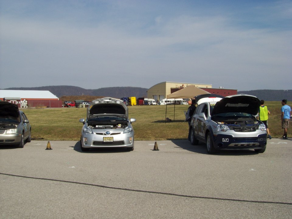

    BP, I leave the bottom blocked all year because the tubes are secured with twist ties. Engine coolant temp seldom gets to 200F and is rather stable. Inverter coolant temp varies a great deal. It starts at the outside air temp and increases with use. I'm not running any hotter than those in the deep South.
    One photo is from last April at the 21st century Automotive Challenge after the day's rally. You can see the top is blocked because that white spot in the grill is the sun bleached label on the pipe insulation. (I know it's tacky but the pieces aren't replaced in their original slots. I should have flipped it for the display but nobody else notices.) The indentation in the bottom tubes are from the twist ties.
    The other photo was taken the next day at the track waiting for inspection before the autocross. The car had the 2nd best time just behind the biodiesel Jetta.
