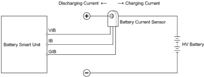

    Im more just researching how the ECU detects state of charge, so i know what to look out for. Technical manual says amps, but how exactly does the ECU measure amps? Is it the same for nimh and lifepo4 batteries?

    This is in the gen 3 New Car Features manual:
    That style of current sensor would be based on Hall effect. Not a lot of choices for measuring DC amps. Hence I'd be fairly confident they're measuring the amps with the same technology for NiMH as for LiFePO4.
    Now, how they interpret from their voltage and current measurements to an estimate of battery state, of course that is all about the chemistry,
