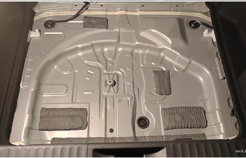

    Here is a question to the true Gen 5 geeks here. Exactly which Gen 5 models have that spare-tire screw hole? I am guessing none of the PHEV models but all of the HEV models perhaps with the exception of the HEV AWD models.
    If Mendel or some others ever have to buy a Gen 5, they will have to know.

    If we can stop the ongoing thread hijacking, can we discuss something useful? (Hint: Gen 4/Gen 5 Prius HEV/PHEV does not have a 12-V battery issue for 99.99% of owners.)
    So, all Gen 5 Prius HEV versions, including the AWD versions, have a spare-tire screw hole, but none of the Gen 5 PHEV versions have it.
    HEV LE:
    HEV XLE AWD:
    HEV PHEV:

    All gen5 HEVs have the spare tire screw hole. No gen5 PHEVs have it. Trim levels don't matter.
    The only difference between the FWD and AWD screw holes is that the FWD version is a stand-alone part, while the AWD screw hole is part of the bracket that mounts/protects the rear motor HV connector.
