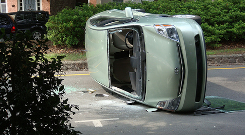

    Must have had swing axles. :D Prius_crash[1].png

    Eldo, That is such a strange picture! Do you know the story?
    I can make up one: It was late at night after the Big College Football Victory in Texas Oil Country and the Free Beer was gone and the Fun Riot took to the streets and there was a Prius and ........

    I think it happened from the owner not changing his trans fluid. This is what happens when the 12V battery goes bad.

    OK, this Bozo had his car packed full of pillows and couldn't see out the windows.
    Why don't people just hire a mover instead of doing crazy stuff like this?
