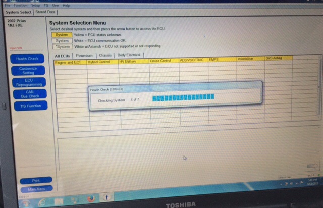

    I hope this is the right place to post this. I bought my 5th prius a few weeks ago, a 2002 with a burnt sensor connector to the battery ecu. I repaired the battery and replaced the battery ecu. After cleaning and balancing the battery I put it back in. I get the failure codes after the engine starts for three seconds. I rented a code reader from Autozone but it would only read the codes about 1 in 40 attempts. I bought the professional code reader from harbor freight and could read no codes. I bought a mini vci j2534 off ebay and used techstream but it could not see any data from any ecu’s, but it does work with my 2006 prius. I am trying to figure out if it is the car or the devices I have tried to read the codes with. Any help would be greatly appreciated.

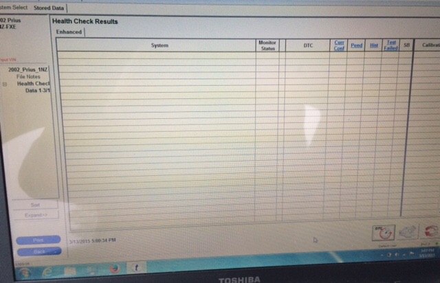

    I am using version 9.3. I am selecting 2002 Prius 1.5. When I do a health check, It says it is communicating with all the ECU's but all the data fields remain blank.

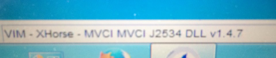

    Theses are the screen caps from attempting to read data today. image.jpg image.jpg image.jpg image.jpg
