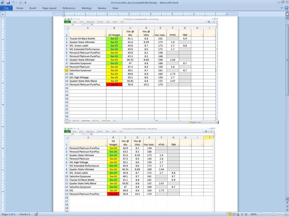

    I like the M1 0w-20 and the Ultra Pennzoil Platinum oils.
    I got bored with 0w-20 and put in 5w-20 UPP last oil change.

    It's winter time, so it's hard to tell. I've also been putting in 10% ethanol, and I idle a lot before I go into work. I've gotten over tracking my mpgs to the tenth of an mpg all the time, but still enjoy getting better than the 10mpg I get in my truck.
    But with this cheaper gas I can afford to drive my truck more. Yay!
    How do I get bored with oil? Because I'm adventurous, and I like to tweak the OMG!!!HE'S DEVIATING FROM THE TOYOTA SCRIPT!!!! types. Recall if you will, that the car is rated for any oil up to 50w depending on the ambient temperatures of your location and the availability of local oil weights. I won't use 50w, but I could if I felt like it.
    Hard to follow instructions? No. I just wanted to use a 5w. Rest assured, however, that the hot viscosity numbers for the 5w-20 that I used sits comfortably within the range of the 0w-20's that people are using.
