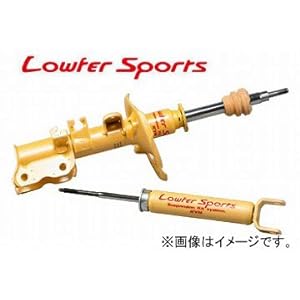

    Not cheap by any means at +$650 for a full set... but Anyone have experience with these?
    KYB struts for lowered Prii... http://www.amazon.co.jp
    Front Right: WST5386R - Front Left: WST5386L - L&R Rear: WSF9160
    The KYB Lowfer Sports suspension kits have been designed to provide a lower ride height with high levels of ride comfort for a range of vehicles.
    • Designed to provide a comfortable ride at low ride height
    • Designed and tested for vehicles carrying 5 passengers to ensure the best possible damper setting and rider comfort
    • Offers 180% extension and 150% compression compared to OEM parts
    • Available for a wide range of vehicles
    • More information available from KYB under Additional Details

    Looks like these would be good for folks who want to lift their Prius too...
