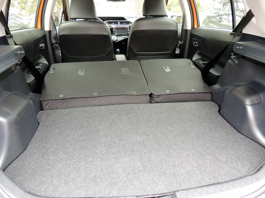

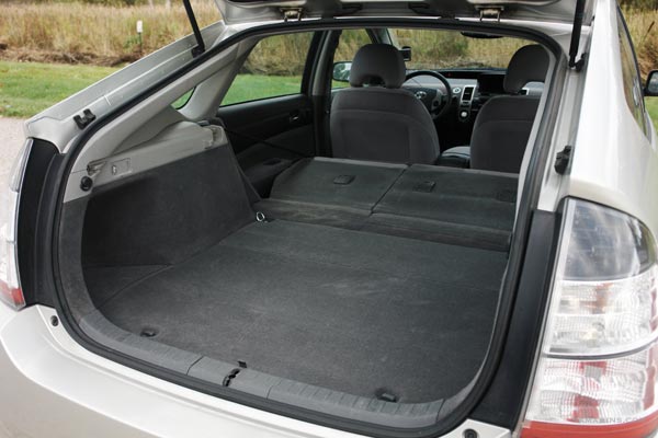

    Are Australian market cars different from North American then? Here's what American market cars look like with a spare (this is a Hong Kong car, but same as NA as far as the seats folding):
    Without spare:
    Prime:
    For comparison, Gen 3:
    Prius c:
    And Gen 2:
    That I do not know; I assume not.
