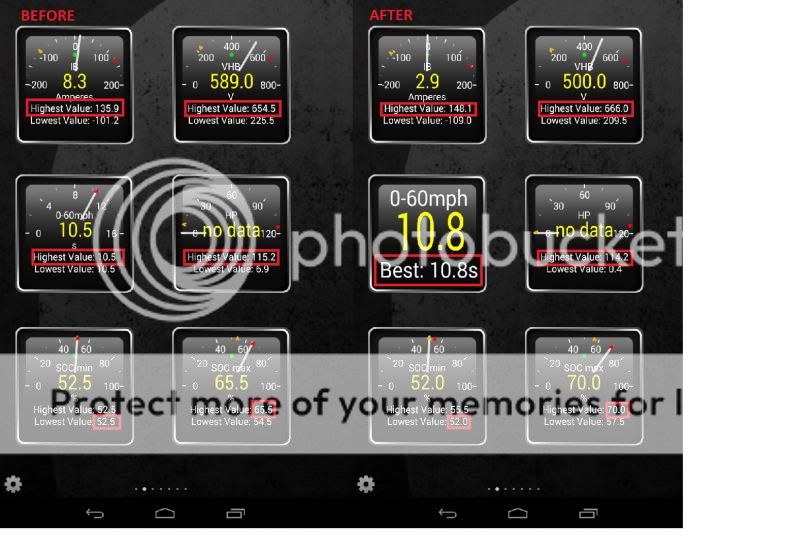

    Well I got it done. Brakes feel different to me. Transition from ice to electric does seem smoother.
    The data shows same through most requested areas. Only difference I see is slightly higher amps and higher SoC after update. Everything else is within error range.

    Condensed for easier viewing..temperature was within 5-10 degrees F of previous run.

    Monitoring the Battery Voltage after Boost it is obvious that the Boost Converter voltage control has been altered. Before the software update the boost voltage would step between 500 and 650VDC. It no longer steps above 500V but ramps up. This is true on both accel and with regen.
    Before the update, on a quick accel the boost voltage would make an immediate step to 650V and remain solidly on 650V until you backed off of the accelerator. After the software update there seems to be a slight hesitation at 500V and then it more like wanders up to 650V than it seems to ramp. This may be the SGII update time though. I think this explains why others have said that when accelerating on ramps, etc. that you no longer have the snap response but you eventually get there.
    On regen, before the update the boost voltage would immediately step to 650V, maintain 650V down to about 20 mph and then ramp down as the car approached the stopping point. I would easily see battery amps in the 70-90A range. After the update the boost voltage once again ramps or wanders up to 650V and then begins to ramp down more quickly. I did not see battery amps above about 70A. As others have indicated that the regen current seems to be less and this is what I am seeing on the SGII.
    While trying a quick acceleration to change lanes, the response was different from what I was used to feeling. The ICE sound increased first as it appeared that the ICE took the first increase and then the electric motors seemed to catch up. It was almost like a hesitation where before it was more of a snap response.
    It also appears that the nominal SOC control point may have shifted upward from the 60% I am used to seeing to 65% now. Others have indicated that their battery level indicates a higher level now. This is what I am seeing on SGII so far.
    So as some of us have expected, the Boost Converter control has been de-tuned to reduce the heat generated on the IGBT's. This is what you would expect to see.

    BTW, Looks like there are slight disagreements between the Torque and SGII numbers.
