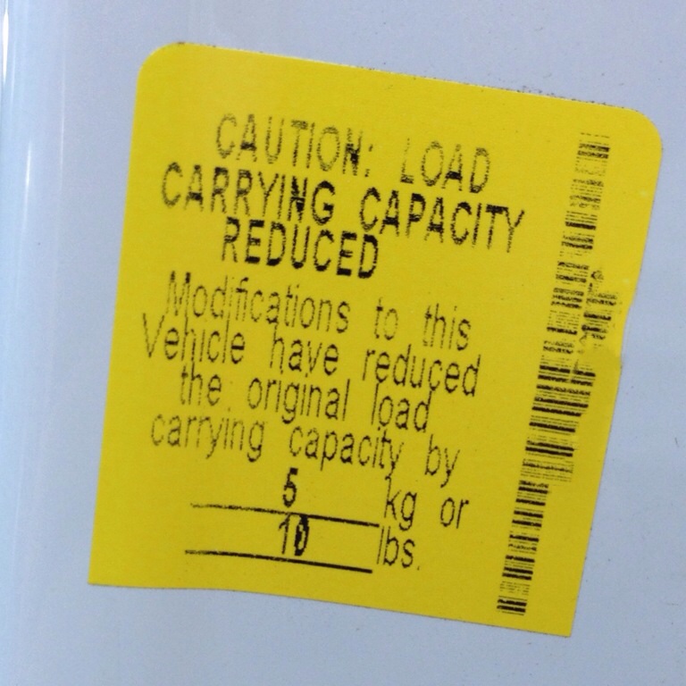

    I only bought my car a week ago and I have the same sticker. It's a 2014 with a state inspection sticker from April. This is on the door frame, didn't look under the hood.
  3. jdcollins5
    jdcollins5 Senior Member
    Aug 30, 2009
    5,131
    1,346
    Wilmington, NC
    The Load Capacity Reduced is a standard sticker applied by your regional distributor and has nothing to do with the recall.

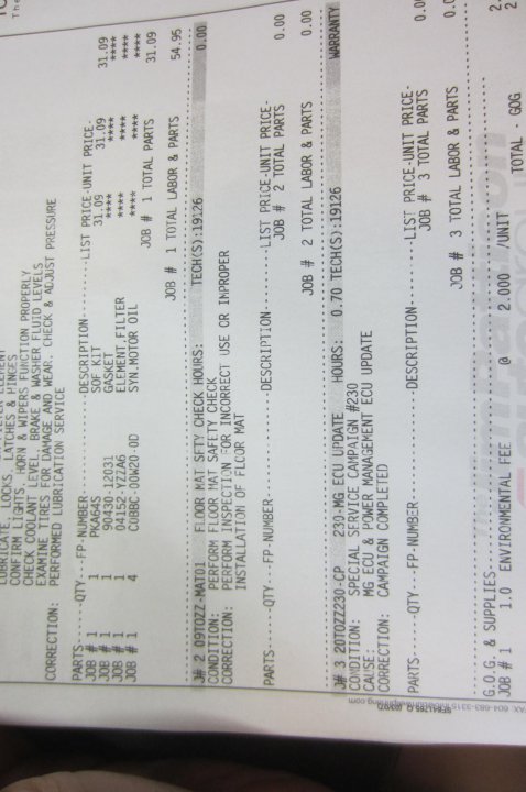

    Hey Guys,
    I have read each and every one of your posts here and have held back on doing this recall for a few months...until today.
    It was time to do my car's 2nd oil change of its life so I decided I would get the recall done too. On one side, I didn't want to lose any acceleration, regen braking response or quietness of the engine (I have heard all the horror stories on the alternative experiences of some on these forums). However, if I don't do the recall, I risk cutting the life expectancy of the inverter or related components. I cannot afford to pay plus/minus $5000 for a new inverter if Toyota deems it my fault that it failed because I didn't take corrective actions.
    So the recall is done and I arrived back from the dealership. On the way back home, I noticed I could regen brake just like before and even at slow speeds. I tried to accelerate up a hill more agressively than usual. There didn't see to be any sort of difference that I noticed in the driveability of the car. One thing I want to point out is that the engine seemed to transition smoother from electric to ICE mode but that could be because the car has been warmed up from my morning drive.
    My best buddy who is the master tech at Toyota did the recall. I noticed the battery was not disconnected during the entire process as I still have my original trip settings. I may report back here with an update after a week of driving but I have a feeling that my mileage will not be affected. According to the vehicle, I'm still getting an instantaneous 4.5L/100km and this jumps to 4.7/100km during winter. Which is 50mpg and up!
    Still a happy camper as of now.
    Attached is my receipt for the work. I apologize ahead of time, the jpg seems corrupted and I cannot rotate it
    Cheers,
    Burna J and robertk328 like this.
