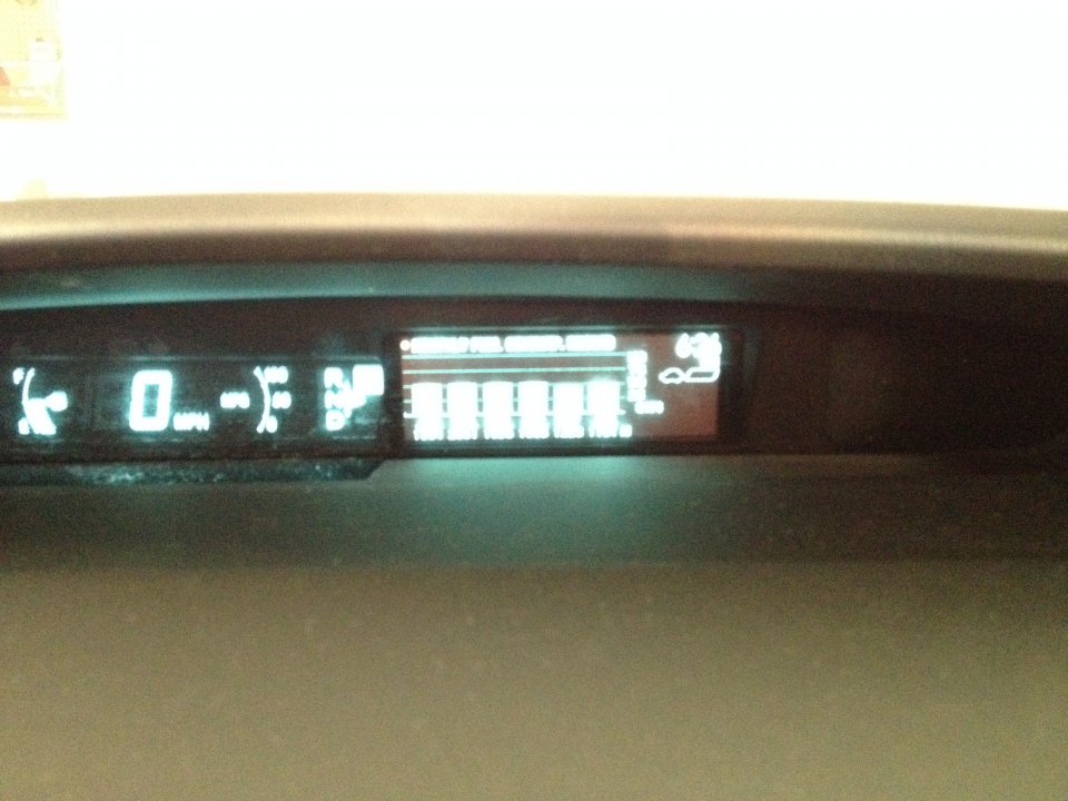

    I had my recall done earlier this as well. I also noticed mileage drops. Also, my monthly average fuel console all suddenly become constant at about $50. Meaning, once it reach $50, the display will not update further. I told the dealer this and they reset the meter for me... now it is happening again. IMG_0818[1].JPG I have included an image. Has anyone experience this?
