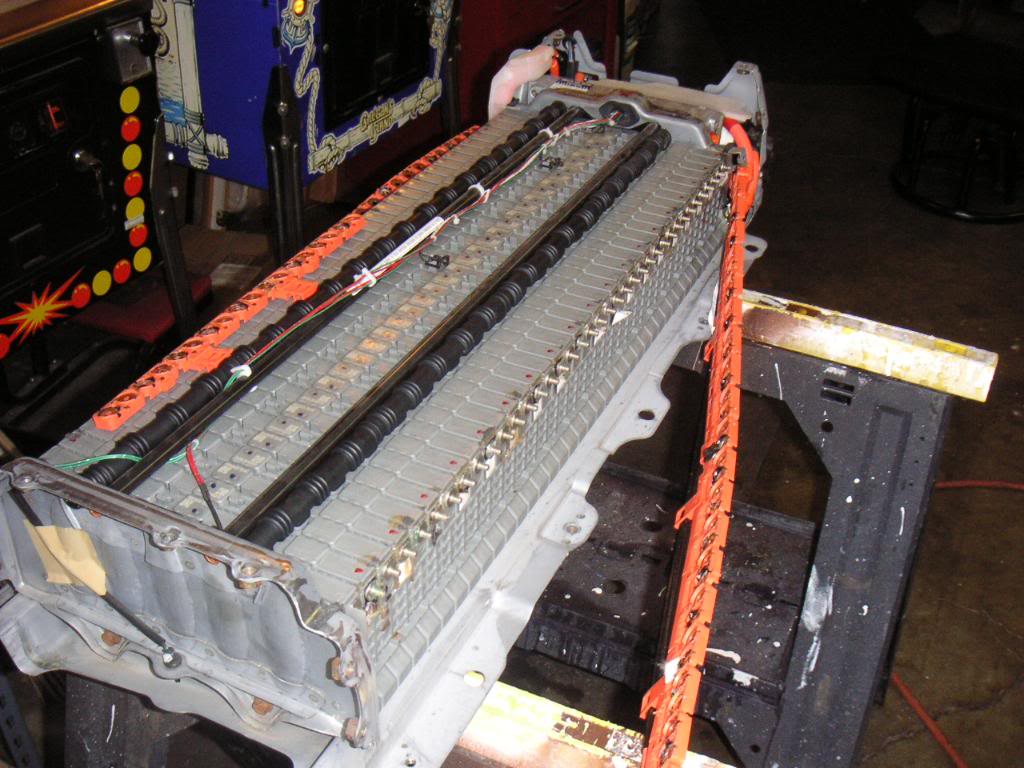

    Prius battery:

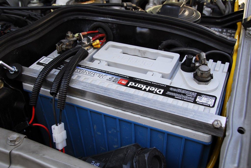

    Group 31 battery: [​IMG]
    Now, BOTH of these batteries have nearly identical capacities, differing in only about 100w/ hr. But one is the size of a piece of paper, and the other is the size of a house. The Prius battery is a D cell battery with the capacity of a AA battery. That's my question: why? Why is it so incredibly large for such a small capacity?

    The DieHard's capacity rating is for its 20 hour discharge rate, i.e. when it delivers just 60 watts. If you double the power to 120 watts, capacity drops significantly. Boost the power delivery even more, and the capacity drops off even more sharply.
    The Prius battery is rated to deliver at 27,000 watts.

    Well that is a weird pair of photos equating a 202V Prius traction battery to one "Diehard Platinum" battery:
    For the Prius, volume is not as important as weight and energy. It is also important to have the 202V battery voltage level more closely matched to the MG1/MG2 voltages whereas a 12V battery requires 202V/12V = 12 times more current for the same amount of power. This would require much larger and heavier cables using the 12V battery compared to the higher voltage, 202V battery.
    We have a 2003 Prius and it has a maximum current charge rate of 50A and discharge at 70A. This is limited by the inverter electronics but provides more than enough capacity for regenerative braking that after 160,000 miles, the brake pads are not even half way worn.

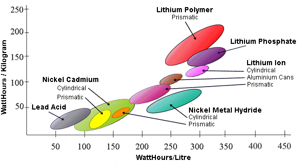

    Thank you! The source: Battery and Cell Chemistries. Battery primer.
    I had a question about why the "Cylindrical" is listed as having such a higher energy volume than the Prismatic. For a single cell, I agree. The cylindrical cross-section minimizes the case overhead but it leads to unusable space when multiple cells are assembled into a higher voltage pack. So let's compare equivalent Ahr capacity, NiMH batteries in cylindrical and prismatic configurations:
    • D-size NiMH rated 50A, 10 Ahr (Source: http://www.batteryspace.com/prod-specs/325.pdf)
      • six cells ~7.2 V
      • (6*37) * 37 * 60.5 = 496947 mm{3} = 496.9 cm{3}
      • 10 / 496.9 = .0201 Ahr/cm{3}
    • Prius Gen I module, handles +50A, 6.5 Ahr (Source: in my spare battery pile and measurements)
      • six cells ~7.2V
      • 10" * 4.5" * .75" = 254 * 114.3 * 19.1 = 554515 mm{3} = 554.5 cm{3}
      • 6.5 / 554.5 = .0177 Ahr/cm{3}
    The volume densities show ~88% difference in energy volume versus the chart suggested change of 165 / 250 ~= 66%. There are other aspects such as the 'head space' inside the Prius module is a larger portion of the volume. Also the cylindrical cell uses a thin steel outer body versus the less dense, thermoplastic case of the Prius module.

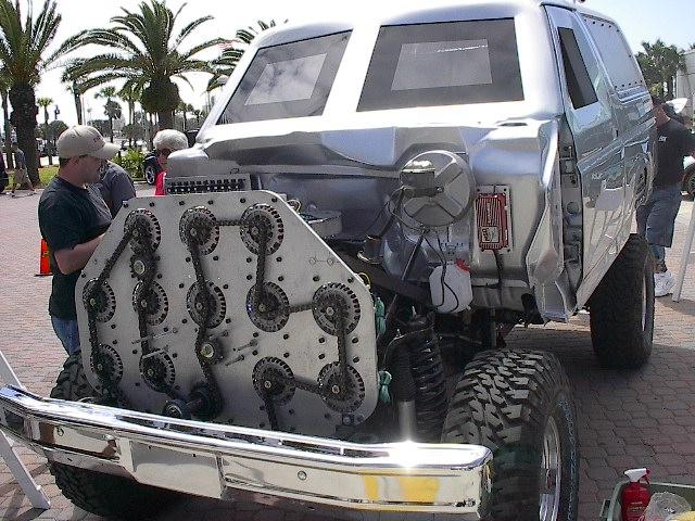

    I'll try to put it in a language you can understand. You obviously understand watts. Google "watts per horsepower" returns 745.7 watts per horse power. I'll give you an example of other EV
    The super bad nice person Tesla Model S P85D - Front motor 221 HP, Rear motor 470 HP, combined 691 HP 691*745.7=515,278.7watts. The Tesla engineered a battery pack that can discharge over 515kw. To put that into a 12v's prospective, it needs to discharge just under 43,000 amps. 2 marine battery would need to discharge 21,500 amps. You can keep multiplying the battery count by2 and divide the discharge amp by 2 until you come to an amount of batteries that discharges what a marine battery can easily handle. 2,048 marine batteries at a discharge rate of 42 amps each. Imagine your 2,048 group 31 marine battery. Tesla uses 7,104 18650cells in their battery pack. This means Tesla manged to put the size of group 31 marine battery into 3 and a half of these
    Also remember that the marine battery example I use is at 100% depth of discharge. This would quickly kill the battery. Tesla's battery technology is 10 years newer than the Prius.
    Now back to the Prius battery
    As I've mentioned before Prius uses 27,000 watts of power and would require 45 marine batteries. Toyota uses 168 NiMH cells. 6 cells per module. Each module measures 11.2 x 0.8 x 4.6 inch. 28 modules total measuring 11.7 x 23.2 x 0.42 in https://techinfo.toyota.com/techInfoPortal/staticcontent/en/techinfo/html/prelogin/docs/3rdprius.pdf page 12. Toyota manged to cram almost 2 marine batteries into a single module.
    I kept going on about the battery supplying power that I forgot the regen. The Prius regens at a rate of 27,000watts. This equates to 1,875 amps at 14.4V. A high output alternator puts out anywhere between 200 and 400 amps. You would need 5 to 9 high output alternators. What does 5 to 9 alternators look like?
    Here's 6 alternators
    Here's 12 alternators
    So somewhere in between.
