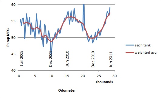

    I was referring only to climate control, not the other items you replied with.
    But Seattle had only 11 days that reached 90F last year. While this was far hotter than a normal year of just 1 or 2 days reaching 90F, it wan't enough to have much impact on your whole summer's mpg.
    If you must be running with AC turned on most of the time in your Gen4, then there is something serious about it that is not better than the Gen3.
    .. very similar to what my 2010 had achieved at the same age and distance:
    Note that the MPG displayed here is pump MPG, not dashboard computer MPG. The later would be a couple points higher.

    Each state is different. Washington state used to put the 10% ethanol in the gas November 1st through March 31st. You can see that your mileage dips in the winter months. Many believe that is because it's colder and takes more energy to heat a car than to cool a car. Those with electric know that the winter months are their worst mileage months. If you want to test my opinion because it's not a theory. Find someone or somewhere that has ethanol free gas. Seal it up good and put it in your empty tank in November or December. A Prius is a hybrid gas as electric so the winter cold months of heating the car do not impact it as much as all electric cars. If you look at gas prices during the 90's and early 2000's. You will notice gas prices always went up in the spring and down in the winter. It's common knowledge that ethanol reduces fuel economy around 10%.
    I don't know how much fuel my Gen 4 Prius tank holds. But I have never put more than 9.8 gallons in my Prius and fill it up between 500-550miles. Usually the pump says somewhere between 8.9-9.6 gallons.
    I have central air at home. I run my AC in my car quite a bit for personal comfort rather than need. I only change the oil because the oil changes are free. That is how reliable Japanese built cars are. The Prius has been completely trouble free.
    Could you provide a screen shot of your ODO with your overall MPG along with total miles driven on your Gen3 Prius? I will post mine if you would like.

    I have not found that to be the case, and based on energy content along you would expect about a 4% decrease in fuel mileage, since 10% ethanol mix has a bit more than 96% as much energy per gallon as 100% gasoline.

    What does that have to do with the actual energy numbers of the fuel? You can do the same math if you would like, and perhaps you can show us how you arrive at the 10% number.
    For a 10% fuel economy hit with 10% ethanol, the ethanol part of the fuel is providing zero energy?
