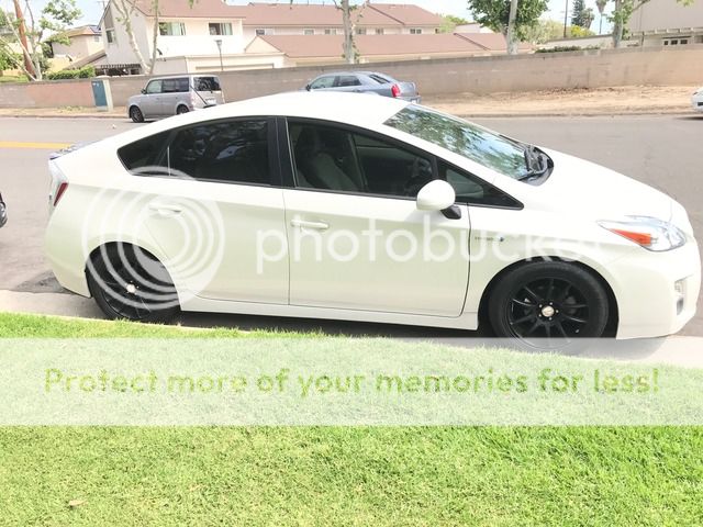

    These aren't the stock rims. These are my 17" rims installed 3 weeks ago.

    Word of caution then. The gen 3 Prius has different steering racks, one for cars that were stock with 15" wheels and another for stock cars that had 17" wheels. If your car had 15"s then you may the opening up Pandora's box. While if it had 17" you should be fine.
