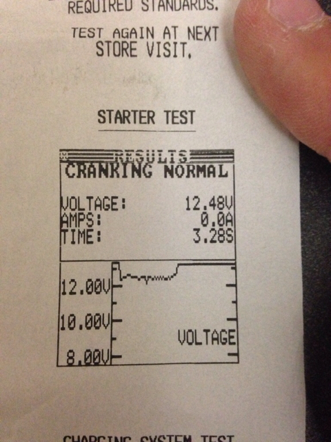

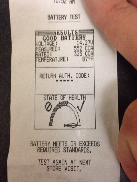

    I had the 12v testing and it was reporting as a good battery at autozone.
  3. bisco
    115,508
    52,896
    unfortunately, the report of a 'good battery' with no specs, is often a misdiagnosis.

    They gave me the specs. It was reporting more than what it is rated for. I think it was 325 and was reporting 500 something. I have to check the receipt that is in the car.
  5. bisco
    115,508
    52,896
    please do, i think voltage maybe more important than 500 something.

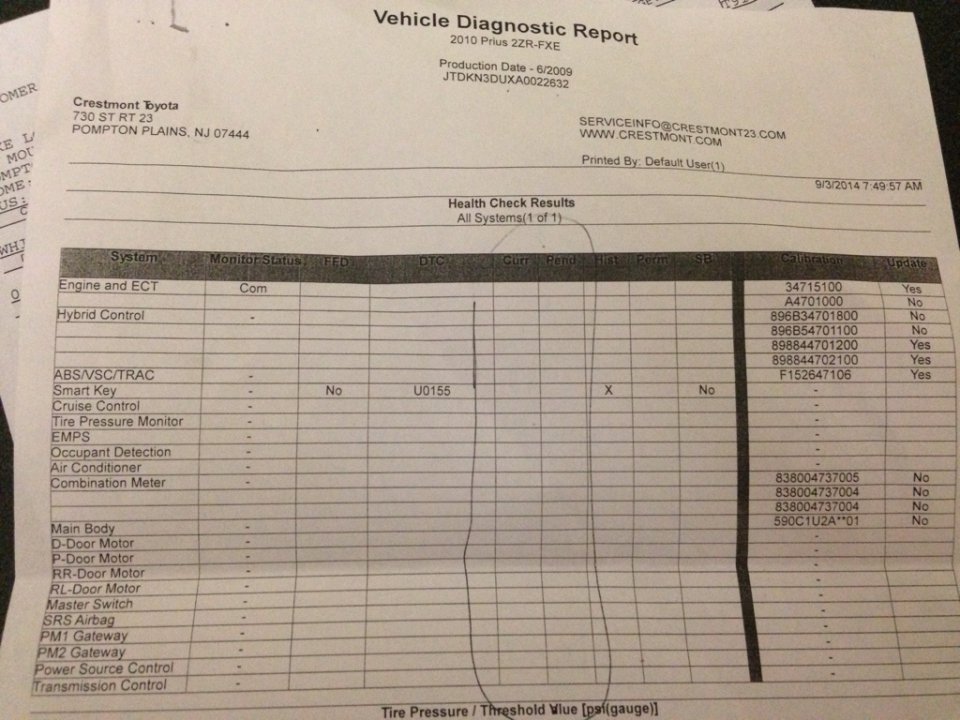

  6. Toddwilks
    Toddwilks Active Member
    Aug 20, 2014
    555
    177
    Whitehouse Station, NJ
    I attached the report from autozone as well as the "health check" the dealer performed. I told them my 09 is like a rocket compared to my 10. Their answer,"well the 10 has a bigger motor and needs more regen braking so it doesn't coast as easy. You need to be on the gas more to make it coast or maintain speed.

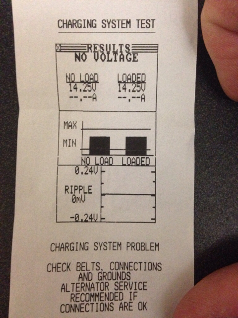

    983
    US
    The dealer answer is pure BS. Check for dragging brakes or hot wheels after driving like a bunch of people told you. The autozone printout is suspect. Was the car on when they tested the battery? It looks like it (14.27V).
