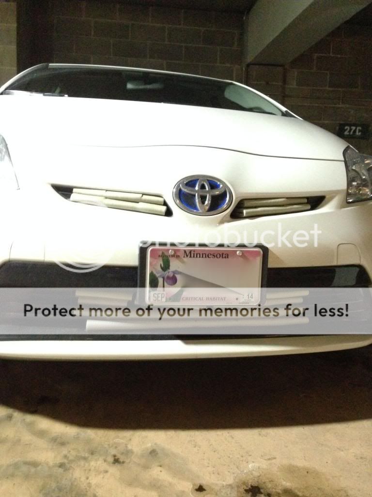

    When we first got our Prius in September I blocked about half of the lower grille. As time went on and it got colder I gradually blocked more. Starting last night we are going to go at least a week with daytime highs in the single digits and overnight lows of -10 to -15 F. Thus, I blocked the rest of the lower grille and all of the top grille. We're now in the deep freeze portion of winter and I wouldn't expect the temp to get above freezing again until spring. I will carefully monitor temps on longer drives to see how warm things get with the grille fully blocked. I really doubt that it will be an issue though. My foam on the bottom grille is a mish-mash of pieces because I blocked it little by little. Thus, there are lots of small gaps where cold air can enter. The upper grille is blocked with two pieces of foam on each side of the Toyota symbol, but there are still gaps where cold air can enter.
    I'll try to remember to take a pic to post later.

    ^ I wouldn't block more than 50% of the upper, due to the Inverter radiator being in that zone.

    Once the outside temp gets below freezing I doubt very much you could overheat the inverter or anything else. It's a struggle to just get things to warm up.

    Check out this link. At those temperatures you won't have an issue. I monitored the underhood temps with my ScanGauge this morning while driving around and the warmest it got under the hood was about 30 degrees above ambient. Since the temp was below zero this is not an issue. In warmer weather it is. Considering that from now until late March we will see few, if any, days with temps above 32 F it won't be an issue.

    Here's a pic
    Driving around today with temps ranging from -10 this morning to -2F now the coolant stayed around 160F in the city and got up to 193F on the highway and stayed at 193F.

    Are you able to monitor the inverter's coolant temperature? I don't think the inverter's performance is helped in any way by having higher temp's, like the engine.

    Yes. See this thread.
