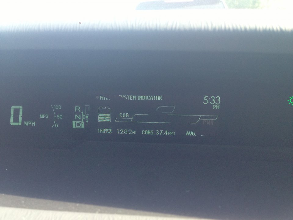

    Hey guys I got a prius 4 2010 and it's been 2 years since I bought this prius and all of a sudden my mpg drop to 37? I drive normal stay between the green changed my tired to michalen did oil change everything. Any problems?

    Check the calibration of your tripmeter miles against either GPS or mile-markers on the road. If your tires are slightly larger diameter:
    • indicated mph will be off - reading lower than true speed
    • indicated MPG will be off - reading lower than true
    For good measure, feel the tires after driving a bit and the hubs. You're looking for heat, the signature of energy loss.
    Also, slack off the speed. You need to be running cruise control at 65-70 mph. Your photo obscured the average mph so it was likely to be 80 mph or better.
