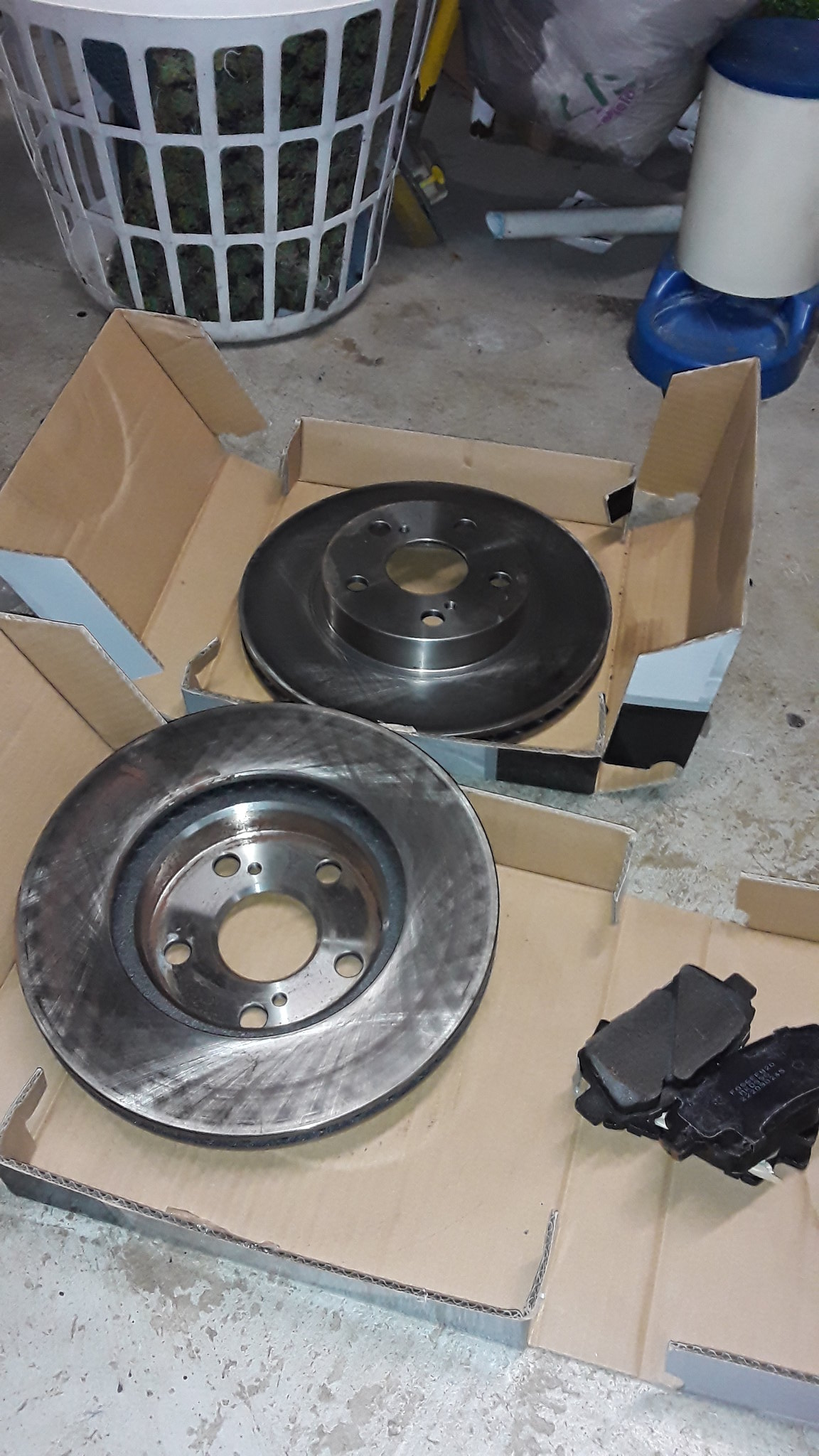

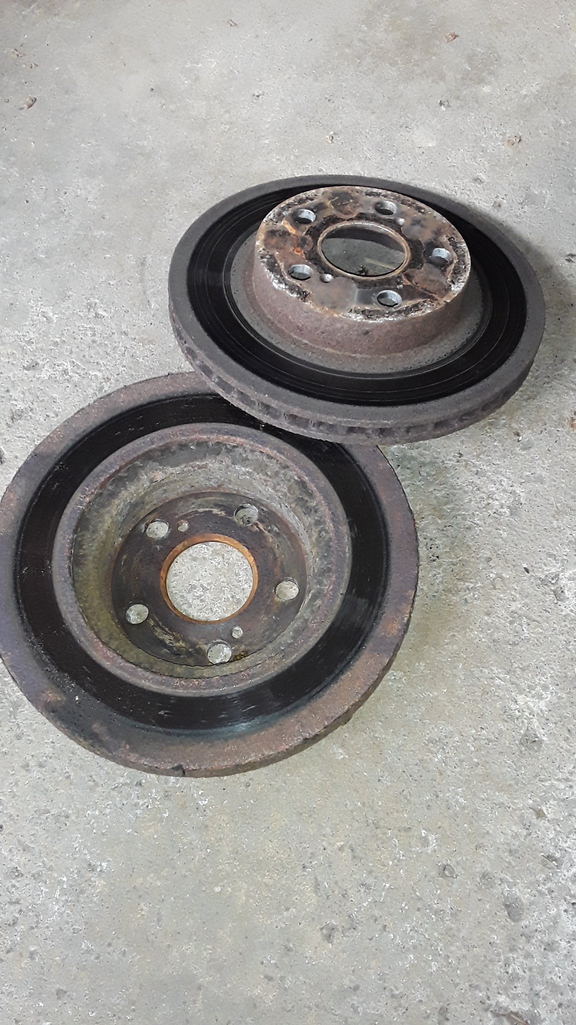

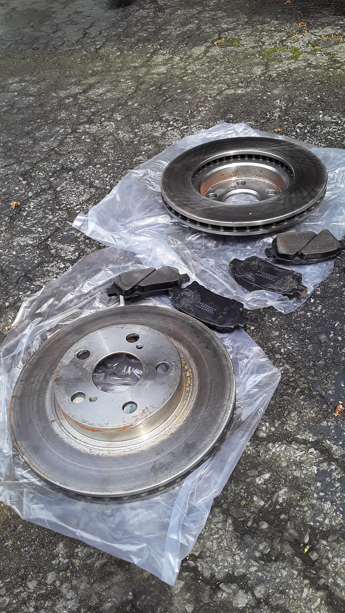

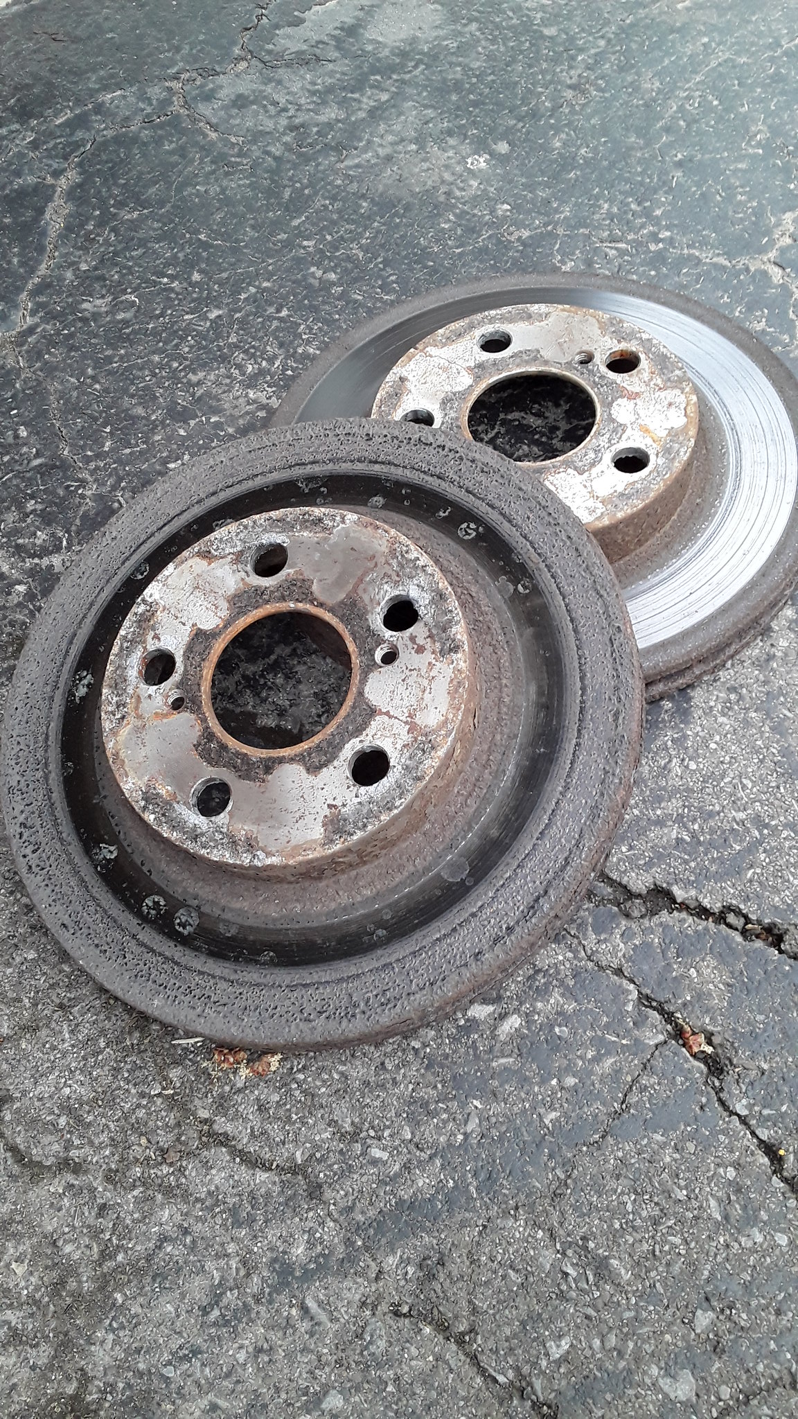

    Anyone else have this happen with their Prius brake rotors?
    Back before I bought my Gen 2, I talked with a lot of owners I encountered about their experiences with their cars. To my surprise, I found most of them claimed to have never changed their brake rotors, or even their pads, even after having owned their cars for over 200,000 miles. I was always very skeptical about that point, but here were all these people insisting that it was so.
    In the years I've owned mine, I've not had that kind of luck with that, having changed mine several times in the few years I've owned the car. Granted, I drive mine a lot, but it's not wear that is the problem for me. It is the very heavy rusting out of the rotors so extremely quickly.
    Particularly gaulling is the last two years where I have had to change out my pads and rotors every year....that is I get one single year, only 12 months out of them....
    Look at these photos, these are the last two rotor changes I've made since the spring of 2020.....
    These were installed last spring ('21);....This is how they ended up this year (spring 2022);
    When installed last year (2021);
    And they replaced these from the year before (1 year on car by spring 2021);
    When those previous ones were fresh the year before (spring 2020);
    Now I know I live in NY, but so did all of the people I asked about their cars, so they were in the same conditions as I.
    I have owned a lot of Toyotas and other cars, and never gone through rotors this fast with any of them.
    Anybody else going through this?

    it is completely normal to see advanced rust on portions of a given disc brake rotor.
    the offset center area aka "the hat" tends to rust quite a lot, especially on the inside. This should be of no concern- once there's a good layer of rust on there, the reaction stops or slows to a rate that doesn't matter relative to the lifespan of a brake rotor.
    Meanwhile the area where the pads are pressed onto the sides of the disc should appear fairly polished, and that repeated friction should sweep that region clean such as the uppermost rotor in your 3rd photo.
    Looking at the second rotor- the one stacked on top in the 3rd photo, I don't see a clean sweep on that rotor face. That suggests to me that there is a problem with the associated caliper or its slide pins.
    To sum up, you may have some evidence of a deeper brake problem... but it isn't rust. The rust is just a symptom; the messenger.

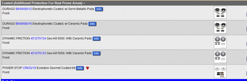

    If after you track down the issue, try coated rotors for rust prone areas, available from Rockauto or your local parts place.
