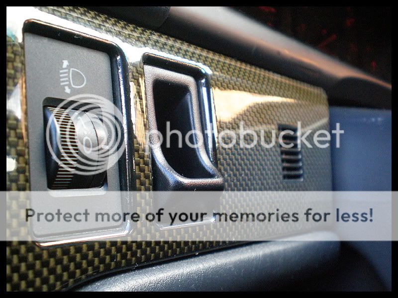

    It's essential for towing because you'll always have that one stupid <insert profanity of choice> who leaves them pointing up at the 747 in the sky blinding anyone at ground level!
    Here's a levelling switch, not from a Prius but its the same thing :)
