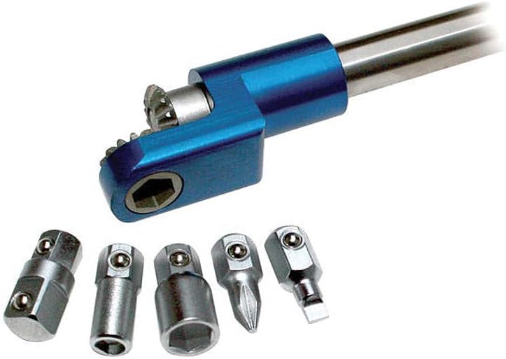

    She ordered a blend door from an online dealer for about $170 and a right-angle carb tool that a guy in a youtube video used for $82. Having done it once, I do believe I could do it with a 1/4" ratcheting wrench, a 1/4" #2 Phillip's bit and a little magnet on the back to keep it from falling out.
    It was a royal pain to do it, but I got it done in about 4 hours. An hour of that was searching for my lost hex bit that fell into the dash. I did take the glove box, lower panel, lower dash and radio out to get a better view. I was under the mistaken impression the hard screw was at the very top. I found it to be in the very back and that would have saved me a lot of time. In this picture, the top hole is for alignment. The left hole is actually visible if you can get your head deep into the footwell.
    I discovered that at 63, I'm getting too old to stand on my head in the floorboard to get at small things in the dash. Despite that, I got it done. The absolute hardest part for me was getting the unyielding actuator in the top left to line up with the tab it slides onto. Once I got that one to fit, the other one was easy to manipulate as it moved freely.
    If I had to do it again, I would have replaced every last one of those Phillips screws with hex-heads to make the job MUCH easier. Too late for me as I've already put it back together and if it lasts another 7 years, I'll be in my early 70s and she'll have to find someone else to do it.
