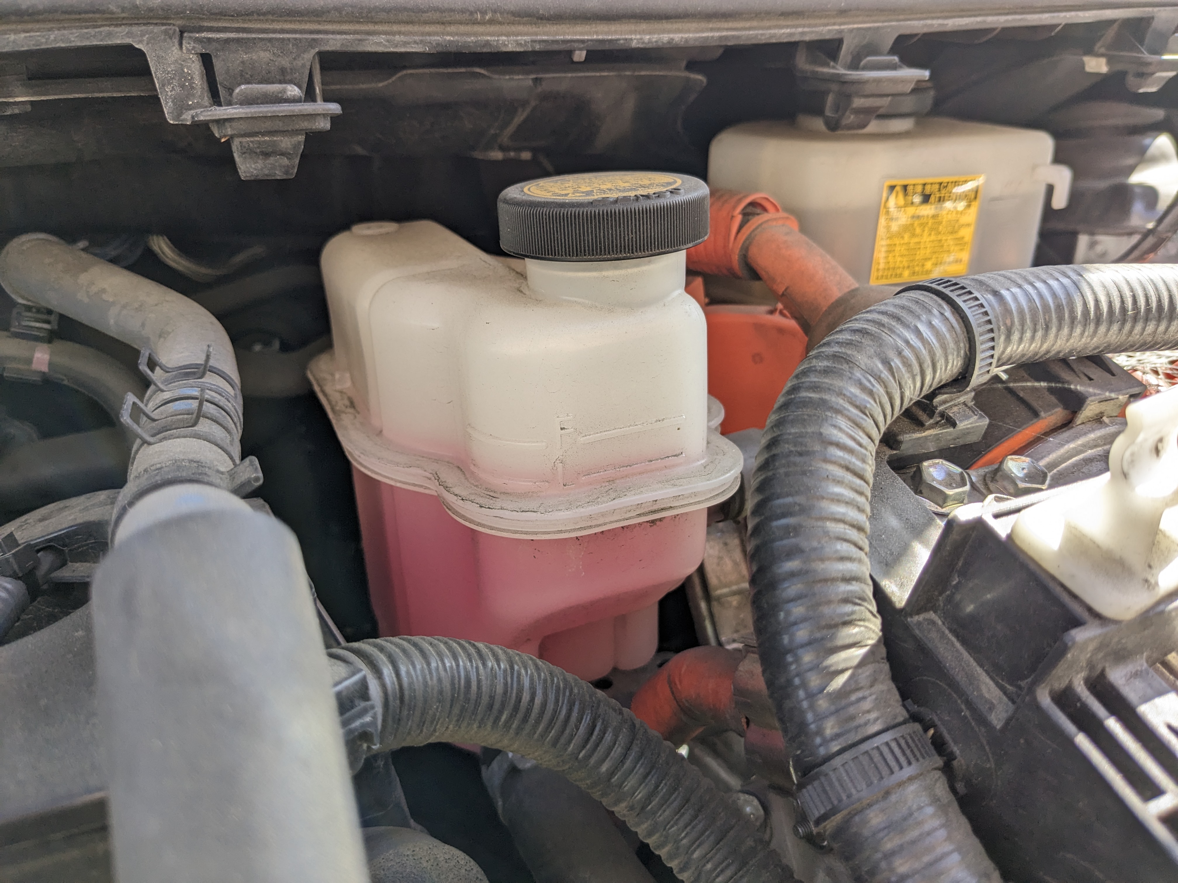

    Have you popped the hood and looked at the inverter coolant level?

  4. legoadan
    legoadan Member
    Mar 27, 2014
    166
    71
    Northern California
    2014 Prius c
    Looks a little low, but nothing dangerous. It's right above the "low" line I think (though the car is parked on a slight slope).

    When the car is on, can you feel the inverter coolant pump vibrating? it's right in front of the inverter, put your hand on it to see if it is vibrating.
  6. legoadan
    legoadan Member
    Mar 27, 2014
    166
    71
    Northern California
    2014 Prius c
    Sorry for the delay. I often forget to check back on the forums. I did check the pump and it seemed to be working. I also asked a tech to look at it and they said it was fine. So I'm leaning towards ruling that out.
