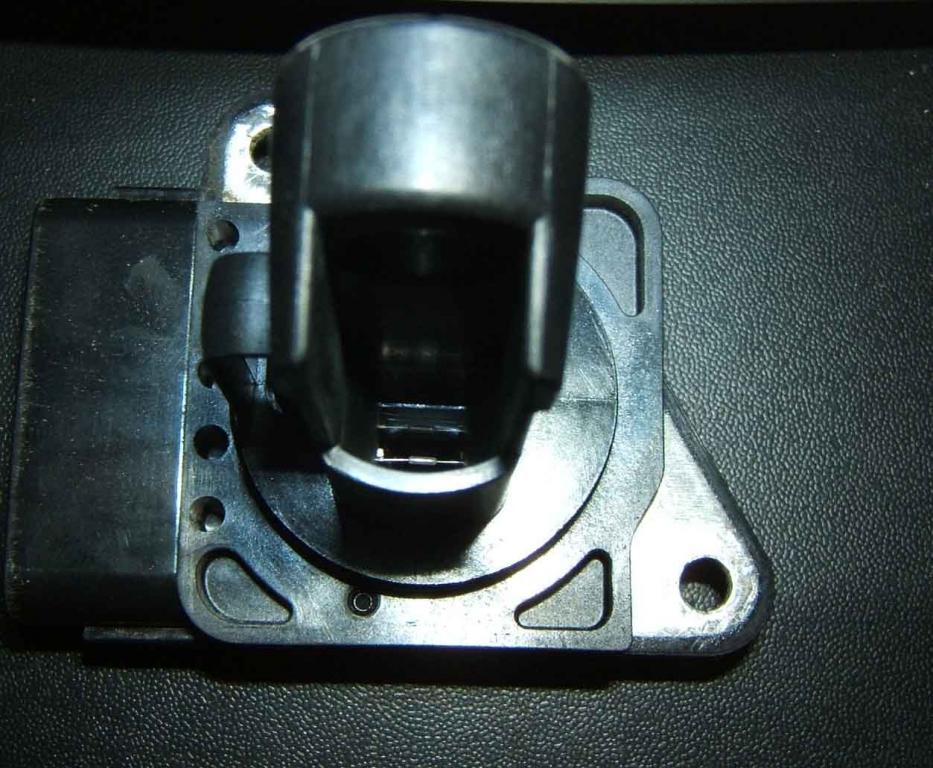

  13. ChapmanF
    28,621
    18,954
    That would be pretty much car-maintenance theater.
    If you look closely at this photo of a MAF sensor, you can make out the two fine wires deep down its throat.
    You're not going to get any angle where your sprayed CRC cleaner reaches those wires, unless you take the sensor out of the duct.
    The good news is, that's very easy to do.
    Cleaning the sensor won't hurt anything (as long as proper MAF cleaner is used, and you don't touch the wires with anything but the sprayed cleaner). It also probably isn't badly needed, if the engine is running well, with no codes about the sensor or mixture, and reasonable fuel-trim numbers.
