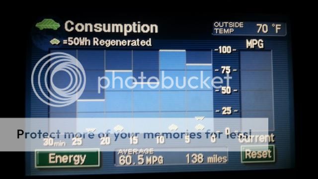

    This is my trip home from Target a few weeks ago. Total distance was about 16 miles, 12 of them on the freeway with the cruise set at 61-63MPH. Freeway portion was probably from 22min to 10min. Oil was replaced by the dealer before we bought it, so unsure what it is. Tires are Goodyear Viva Authority's, OEM size, at 51PSI. I'm a firm believer that running the tires at 51PSI accounts for a few of my MPGs. I might drop them down to ~38PSI in a few tanks to see if there is a noticeable difference.
