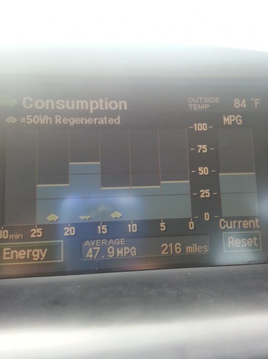

    Update! So I've been staying away from the interstate for a while now, been averaging about 48-49 mpg. Yay! Any way I've really been missing my intestate drives. so I needed to head in to a near by town, so I decided to take the interstate. Disappointed.. again :( I'll up load a picture

    This was a cold start. the first 10 minutes are country roads, the third section is when i get on the interstate at set the cruise to 70 MPH, slight up and down hills with AC on low.
    The fourth block i said to hell with it and set the cruise to 80 MPH. no damn difference

    i started out with 48.9 MPG before i got on the interstate. Tires inflated to about 40 psi.. something like that. so they are not low,
    One more thing, if i am following a row of cars, say @ 75 MPH i seem to get close to 50 MPG due to no cruise control and sort of pulse and glide. With Cruise control there is hardly ever arrows coming form the battery
