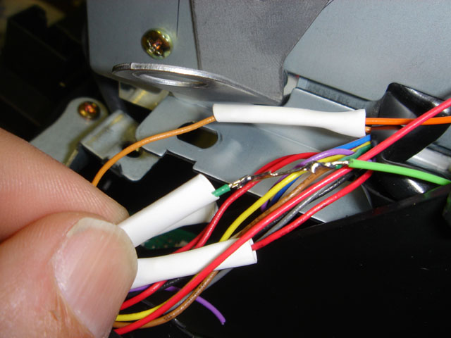

    Looks like there is a more accessible location for the speed sensor wire
    to the MultiDisplay. And the wire to the Nav ECU is right next to it.
    They are located behind the A/C panel just to the right of the radio.
    It snaps out if you pull it toward the back of the vehicle.
    The violet wire to the MultiDisplay (to pin 25 of M13) is at location
    5E-12 of center connector #2. You could cut it here to gain
    access to BlueTooth phone features while moving (at the expense
    of MPG 5 minute interval bargraph and animated tire display).
    A switch in series with this wire allows selecting between default
    and moving-phone mode.
    The violet wire to the Nav ECU (to pin 5 of N2) is at location
    5E-11 of center connector #2. A switch in series with this
    line gives you the GPS lockout defeat described elsewhere in this forum.
    It's just an alternate location to the under-seat cut.
    See photo for more detail.
    Cut at your own risk! Anyone know how to coax these pins out of this
    connector housing?

    Once again Brosnan, thanks and excellent work. That's much more accessible and seems like a great access point for one of those DPDT or DPST switches for single switch access to NAV and BT.

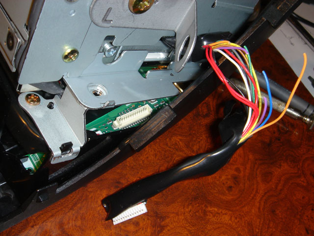

    schematic for continuous nav lockout defeat.
    Well, the TLC555 based "fake speed signal" version of the
    nav speed lockout seems to work. When the switch is
    flipped away from "normal" to "defeat", it gives continuous
    access to the map features which are normally blocked
    when moving. No need to flip the switch back and forth
    to avoid GPS speed lockout. Since it fakes movement at
    about 4mph, the map position is not accurate until a few
    seconds after the switch is flipped back to "normal".
    Some soldering is required, as you can see from the photo
    below. You'll also have to cut the violet wire to the
    Nav ECU. It can be found behind an A/C outlet as shown
    earlier in this thread.
    I used a magnetic switch from Hometech for ESD isolation
    (http://www.hometech.com/security/acc.html#AS-507381BW)
    but a normal toggle switch (SinglePoleDoubleThrow) will also
    work. You should find all the parts at Radio Shack. If you
    can't find exact values for the 27KOhm resistor you can
    substitute anything from 10K to 100K. If you can't find
    the exact 0.22uF capacitor or 820KOhm resistor, you can
    choose similar values but keep the product of the two about
    0.18seconds. That will keep the output frequency around
    the same 4.7pulses per second that I've got. Too fast and
    you'll get the speed sensor lockout. Too slow and you'll
    get GPS speed lockout (and some other odd effects).
    The oscillator board consumes about 2mA from the 13.5V
    supply, so you should connect it to switched power. For
    example, the "cigarette lighter" outlet is an easy spot to tap.
    Eventually I see this being driven by the DEST and MAP, etc
    buttons as discussed earlier. But this part's ready now in
    case anyone wants it. As they say, some assembly required.
    Install at your own risk.
    Drive carefully!

    For those electronics-minded Prius fans out there, here's a circuit which
    lets you access all nav and phone features while moving without flipping
    any switches. It just fakes slow (or no) speed signals to the Nav ECU
    or MultiDisplay as appropriate. When you press DEST, INFO or MENU
    it sends ~3mph fake signals to the Nav ECU while you use features
    on those screens. Then when you pop to a different screen
    (press either MAP button, CLIMATE or AUDIO), it restores the
    speed signals. When you press the Phone OFF HOOK button
    to make a call it breaks the speed signal connection to the
    MultiDisplay until you press the HangUP button.
    This project involves removal and modification to the expensive
    MultiDisplay unit, so it's definitely a do at your own risk project!
    Let me know if you want more pictures or details.
    Drive safely!

  18. brosnan
    brosnan Member
    May 2, 2004
    159
    Silicon Valley
    OK, I'll write up more detailed instructions with some photos.
    For now, just a few extra comments.
    The wires needed come from 3 locations:
    6 wires from the MultiDisplay.
    5 wires from the Center Connector #2 behind the A/C outlet just right of the radio.
    2 wires for power and ground from the "cigarette lighter" socket.
    As far as I can tell, this modification does not affect the average
    MPG or trip distance shown on the Consumption Screen.
    The bar graph history is affected by phone usage. If you're
    on the phone for more than 5 minutes, you'll have some
    blank bar graph elements.
    By the way, I'm giving up on the "I agree" auto-press function.
    It sure would be nice to have a "magic finger" press the "I agree"
    soft button for you every time the map is brought up after each
    powerup. I had a look inside the MultiDisplay and you'd need to
    dissassemble more of it than I care to in order to solve this
    annoyance. So that challenge is left to the group!
