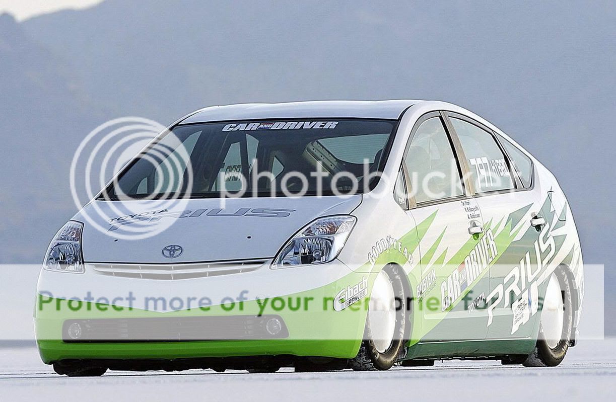

    As or the picture below, we would need more information on the actual weight and dimensions of the wheels and tires they have on that car. That may have went larger for a number of reasons and I doubt fuel economy even factored into their decision.

    But 4 wheels are require to keep the car stable at high speeds. :)

    "Wade had sized the front-wheel arches for larger tires but left the rear arches alone since only the drive wheels need to be bigger to get the ratio effect. The mixed tire sizes, though good for speed, would be perceived by the computer as a dire safety hazard." Got Hybrid? - Over 130 mph
    This is one reason I think they were working against the stock software.

    could be telephoto compression but the rears actually look larger here. There isnt any EXIF meta data in the image. This car is lowered about as far as it will go, thats somewhere around 4"

    I put a fine grid on it in PhotoShop. As near as I can see in the picture, the center of the wheel front and rear wheel covers are the same distance above the contact point of the tires.
    There is lot of telephoto in that picture because the mountains in the rear don't look nearly that high when you are there, so the ties could be the same size or the rears slightly bigger according to the limits of my 1/2 arsed photo interpretation.
    I suspect that picture was taken without the bigger wheels on the front.

    looking harder
    when the back door handle is wider than the front one ....
    it has to be telephoto compression at work
    this was a crop from a larger image BTW
    surprising how pretty the car is when 1" off the deck

    I always wondered why some cars like the Corvette came with larger rear wheels.
