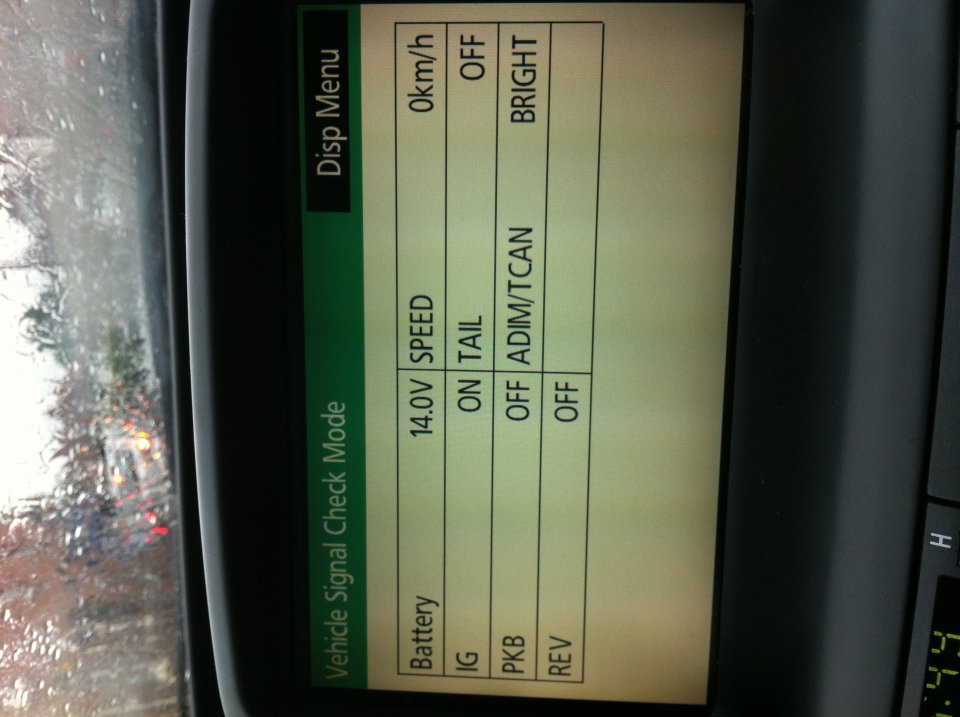

    Hmmmm...picture looks like the car is not in ready so you can't possibly be in reverse. Looks like your in acc and your battery is really bad.

    My rev is off when in signal check. This does not change when engaging reverse. Should the do something?

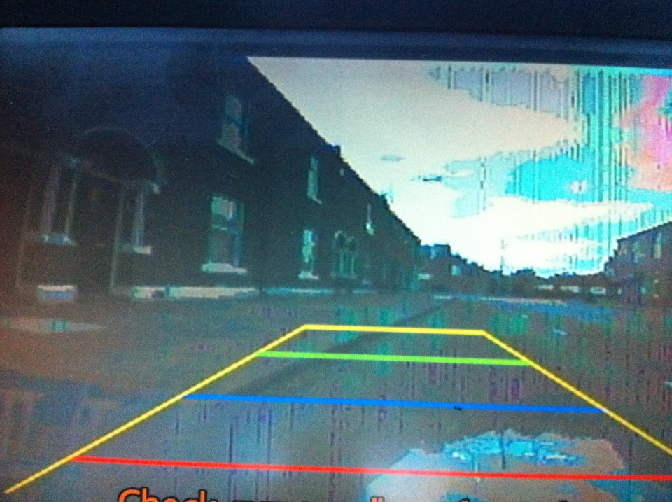

    Long day at it today. Got it all working as it should, well kinda. The picture quality is awful. Is this due to eBay camera or is it something I have done wrong. I actually used telephone able to extend RCA as its flat and easy to route. Wondering if its just too low a gauge.
    Thanks for the help thus far.
  16. priusro
    priusro Junior Member
    Jun 22, 2013
    Bucharest, Romania
    Congrats on getting it to work!
    I have the same problem with the quality, sometimes only black and white. I've tested the cam before install and it was working perfect, as long as it has sufficient light. Like you, had to extend it about 1 meter or so and I've used a double audio cable, now I blame the quality problems on that piece of cable, mostly not being shielded...and maybe not soldering any connections I've made.
    Now I'm waiting for a replacement camera, as the first one was not waterproof, at all. After the first car wash, water slowly went in from the back of the camera and it was literally filling the entire body.
    So, for your sake, add some sealant all around the back, including where the cable goes into the camera, just to make sure.

  18. edthefox5
    edthefox5 Senior Member
    Jul 25, 2007
    10,096
    4,829
    Clearwater, Florida
    I checked my 07 Package #2 with camera and in the mfd mode mine says REV----OFF too. So disregard that on your car.
  19. edthefox5
    Jul 25, 2007
    10,096
    4,829
    Clearwater, Florida
    Must be shielded audio cable. Phone won't work. It may but will be grainy and black & white.
    Sometimes in a house in a pinch you can butt splice the shield and signal together to extend it but usually not in a car and especially not in a Prius. I would solder a male rca connector on the end and then get an rca barrel to connect both males. Then tape it up so it won't come loose. Standard car audio stuff.
    When in doubt see my post above about bringing a dvd out to the car. Hook the camera line out back to the dvd yellow jack of the dvd player and see how it looks. Then you will know for sure is it camera or your f'ed up line cord.
